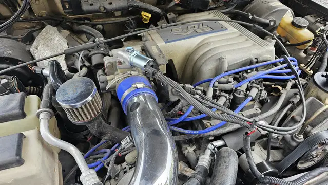

After getting an estimate on how much it would run me to fix up my Xploder with all new exhaust, cold side piping, and a bunch of other stuff done up the "right" way... I've decided to convert my Xploder back to NA form so that I can actually ENJOY the truck before I die of old age.
Anyways... To start it off I ordered up a MAC cold air intake (I do not have the stock intake) and sold my FMS headers on ebay.
I plan on buying a set of torque monster headers in the next week or so but am still up in the air on how I should run my exhaust from a performance "speed" perspective. I do not plan on doing much, if any, off road driving, so am looking for a setup that improves take off and speed for spirited pavement driving that sounds good.
I already have the spare tire removed (and will be keeping it off, I have free towing anyways lol)... What would an optimal setup be with the above in mind and no worry of a spare tire being in the way? True duals (straight pipe off of each header, thru separate mufflers, and out the sides), or a dual exhaust both going into a 2 in 2 out "H" pipe style muffler and then out the sides? Or something else? In all cases I won't be running any cats.
I also plan to re-tune my car since currently it is tuned for the turbo setup which obviously will no longer apply once I rip everything out.

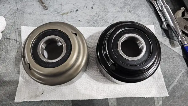

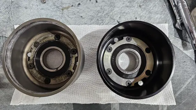

As for the waterpump.. I'm not sure, though I think they do require occasional maintenance and such. I'm just hopeful they will sell me the retainer ring so I can just swap it in and be on my way! Lol.
Got an email back from Meziere.. they will sell me just the retainer ring with bolts for $33 or the entire pulley assembly (idler, bushing, retainer ring, etc) for $170. He mentioned that if the bearing can spin within the idler piece then it's worn and will cause the new retainer ring to wear out so I told him I'll order the entire setup and play it safe :D
Got my PayPal invoice from Meziere and ordered the replacement parts. Just got FedEx tracking info and if all stays on track it looks like my package will arrive Thursday! :)
New idler assembly came in, looks good. Black instead of gray and seems a little thinner but the weight for the old and new assembly reads as 1lbs 7oz for both :D
