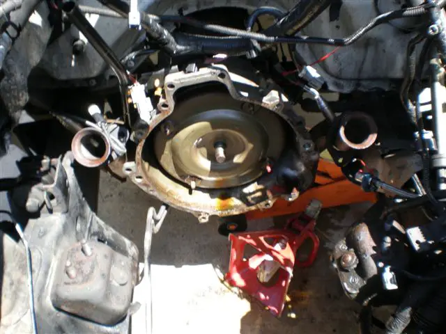

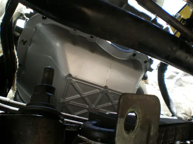

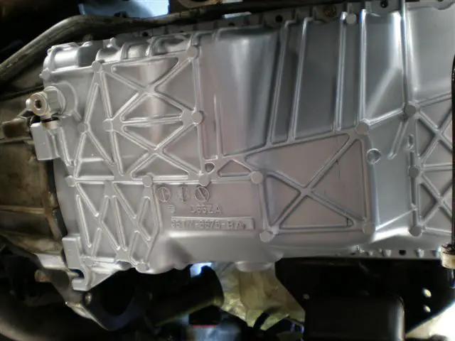

The following pictures show the ease of removing the oil pan, if needed, on a 2wd Gen II Explorer...You can see there is no frame or crossmember in the way of dropping the pan...
If your truck is a 4wd there will be the transfer case[ I think] and the front axle in the way and raising the engine is necessary to remove the pan...

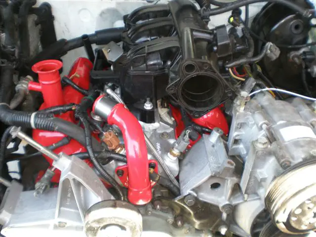

I was running the original engine in my 99 X for the last 15 months and noticed a slight coolant leak...Lived with it for a while then decided to replace the head gaskets and put the new heads on that I bought when I bought the truck...
If you need to replace the timing cover gasket, I would definitely replace the timing components...When I pulled mine apart with lots of sludge and 169,165 miles on the engine they still looked tight but I was going to replace them as well...Now I have a new aftermarket timing set with tensioner and guides since the shortblock came with new timing chain and other components...
What I found was 2 cylinders that looked like hell...So I bought a Motorcraft remanufactured shortblock and used the new parts I already had to complete the engine...New heads, roller lifters, water pump, oil pump[came with shortblock], inkectors, rocker arms, pushrods, and a little bling to top off the engine...

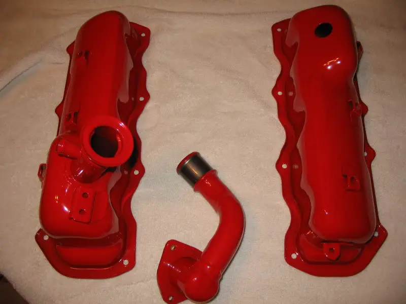

The valve covers and the thermostat neck were powder coated by Turdle on this site...
