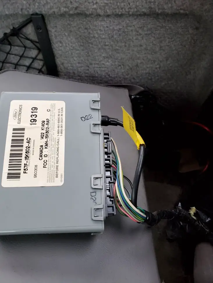

Door code is on the RAP module. 35737 is the door code on the sample pic.

I'd like to keep the functionality of the combination keypad but disable the remote control keyfob access because I believe on the 2000 Explorer there are already electronic tools to easily defeat/clone the remote control keyfob access and someone has been remotely locking the doors to my Explorer and setting off the panic alarm. Things have also been stolen from my Explorer when it's been parked on the street -- without any evidence of forced entry.
Dunno difference between my 96 and yours, but on mine, unplugging the RAP module, killed the keyless with the fob, and the keypad...
Thanks, maybe I'll see if there's a way to remove the antenna to the RAP module or, if worse comes to worse, cut it.
It's possible that removing the external antenna only greatly reduces the range and someone standing right next to the vehicle could still trigger it, keeping in mind that while you can test that with your fob, someone with a tool could have one that produces a stronger signal than a fob which is inherently limited by the low 3V battery power source. Then again I could be wrong, if the casing of the RAP module is metal or internally shielded, the antenna opening may be too small for radio RX or could be patched over with metal tape.

The module is in the left quarter panel. Remove the panel on the left side rear and look forward of the opening to see the code. The factory code stays in the module, you can add the second code but the factory code still stays.
The antenna for the RAP is internal to the module. The module has a plastic case. I have never seen one that is external. If you are concerned about the entry, you need to delete/replace all of your fobs. If you think that someone is using the factory keyless entry code you must replace the RAP module. Please, remember that RAP is your antitheft/alarm system. PATS is only able to deny a start. Your RAP module is woven into a group of modules. Your GEM/CTM also known as your BCM, PATS, and your RAP module all need each other to function correctly.
You might be right, but then:
1) Why there is an antenna lead shown in the picture toypaseo posted?
2) Most modern plastic cased things that do RF, have metal shielding on the interior, along the signal path at a minimum, until the antenna element. Common example is the wifi routers many of us own.
3) Even if it has an internal antenna, if the casing can be opened non-destructively then the antenna can be disconnected, even if it is just a trace on a PCB and that gets cut with a knife - then soldered back together later if necessary.
Ford has produced RAPs with both internal and external antennas. Here's a pic of one with external, that's what the thick black wire is for.
That is wrong generation for the OP's vehicle. Will pop my module and do a picture.
