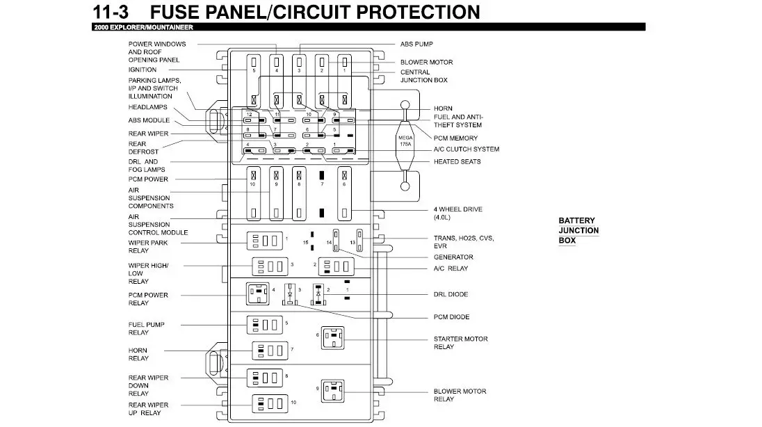

So let me tell you'll what I've done so far. First I've checked the battery and there is plenty of juice. The lights dim and I hear a click inside so I assumed it's not the ignition switch. The relay in the under hood fuse box clicks when I try to start. I've switch around the three like relays in the fuse box and it changes nothing. I keep reading that there is a ignition starter relay mounted near the battery, even found part online, but I'd be damned if I can find it. Traced wires from the starter and they go directly to the fuse box and the battery, no relay. I've also tried the old "tap the soilonoid" trick and nothing. I also don't feel or hear anything at the starter when I try to turn it over. Soooo, it's got to be the starter right? It's 17 years old so that would make a lot of sense. Just a pain in the ass to remove from what I've read.
