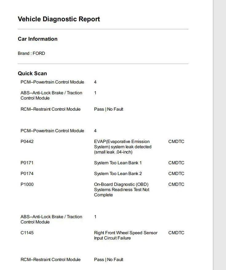

I've attached two different scanning results I've gotten. The one showed a small evap leak but the next time I drove and scanned it didn't pop up again. So I'm not sure exactly what that would mean.
Lean both banks is usually bad intake o rings on a sohc engine
Your 2000
Has upper and lower plenum o rings and they likely need to be replaced. They dry up and start leaking. It’s a pretty straight forward job

Your lean codes are on both banks
Lean means the oxygen sensors have detected a lean condition and the computer has attempted to add fuel to solve it and was unable. So you get codes
Lean codes first thing to do is check fuel rail pressure cold and warm, especially when the truck is acting up.
Spec is 64 psi at the rail

Thanks. I'll see if i can either buy a fuel pressure tester or borrow one. The engine has about 120k on it but was recently installed after the last one blew up at 170k via timing chain issues. I had a friend of of a friend install it and I'm wondering if when he assembles the intake manifold if he didn't replace the gaskets or didn't torque it down right and it might be leaking.
