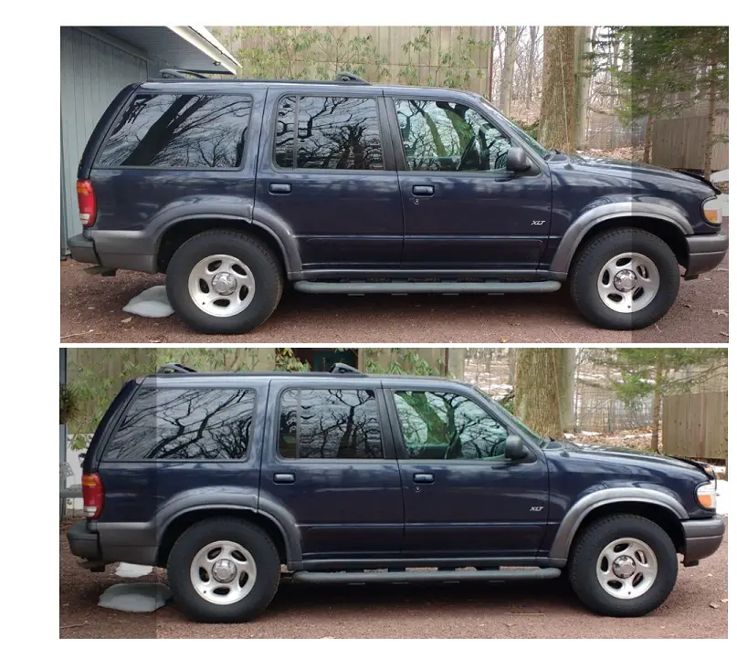

Hey Everyone,
I know there are a lot of threads discussing this shock as a cure for SAS, but I wanted to post some before and after pics, and share my install experience.
My explorer was beginning to show some sag, especially with a full tank of gas. As you can see from the pics, it was not a very noticeable sag, but the ride was suffering. At some point a prior owner replaced the stock shocks with Monroe Reflex which were at the end of their life.
I thought the removal of the old shocks would be the most challenging part. I sprayed the bottom bolts with PB Blaster a few days prior to the install of the Monroe 58617. I could get zero movement from the bolts even when banging a wrench with a small sledge. I went to harbor freight and bought a cheap electric impact wrench and some deep impact sockets. The impact wrench was able to free the bolts (can't say enough good things about the harbor freight impact gun). I did not have to remove the carbon canister stuff on the drivers side to access the top bolts.
Once the old shocks were out, the adventure began with getting the new ones in. Maybe someone can let me know what I was missing with how to get the new shocks compressed up to the bottom mounting bracket. I had to jack up the body from my tow hitch, and then compress the shock with a second smaller jack. Maybe the spring over the shock makes these extra difficult to get compressed, but this was very challenging.
The final result was a noticeable raise to the rear, possibly beyond factory height. I'll try to post pics again after they have settled. The handling is greatly improved. Initially these shocks do seem stiff, but the increase in stability and reduction in body roll is incredible.
MonroeLoad Adjusting Shock Absorber
Part No 58617
Not sure how to get the images to appear inline. The link below will also work.
s!AgVxUNC8xkipmjzcj_p6YPfkjX5t
s!AgVxUNC8xkipmjuGT97wzbksgjoe
https://1drv.ms/f/s!AgVxUNC8xkipmj1HXrDneM2sYEJt

I too had trouble with the lower shock bolts, but the nuts never came loose, instead I sheared them off from trying to get them loose with a breaker bar. After I put the new bolts and nuts on, I put a healthy blob of grease on the nut and threads to weatherize it a bit... lots of salt being used on roads around here in winter, sometimes even if it doesn't end up snowing much, lol.
The method I used to get the load adjust shocks on was to have the vehicle on jack stands, use the saddle on a floor jack to compress the strut up while the top bolts were loosely on, with a flat, wide pry bar between the end of the strut and the jack saddle, then once it was lifted up into position, the pry bar levered the shock in place, up and inwards slightly, to put the lower bolt in.
I think my rear height ended up about 1/2" to 3/4" over stock or thereabout, but has settled down to about 1/4" above stock now with a full tank of gas, around 2 1/2 years and a few 500+ lb loads later. The ride did soften a little over that time but is still significantly firmer and more control than before the load adjust were put on.
If my using the floor jack to compress them hadn't worked, or if I didn't have a floor jack, I would have looked into using conventional strut assembly spring compressors. AutoZone and probably Advance Auto too, offer them in their loaner tool programs and I've used them before for other vehicles' struts.
However I don't know if the hooks on those spring compressors they have, have the flexibility to handle the smaller spring diameter on these shocks versus the much larger diameter springs typically found on struts. I'd have taken one of the shocks with me to check that before I put down a deposit and dragged the tool home and back.

Thank for posting my pics Toypaseo! The process of compressing the shock with the floor jack was really precarious. I was very close to giving up. After I compressed the shock within the lower mounting bracket, I wedged a screwdriver through the bolt hole on the bracket and into the shock bolt hole and pried it up and was able to get the bolt partially in. I then had to drive the bolt through with a sledge. I think i mucked up the threads on the bolt and had to use my impact gun to get the nut back on.

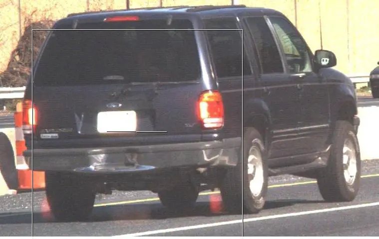

Mine had the same amount of sag yours had.Report back after 3 years and some heavy loads later.Any time i hit a small drop in the pavement they rattle and sound like shit.That's because after 3 years of use the spring is compressed now, and any drop opens up slack between the spring and the plate.They are cheap and easy to swap out so i will just keep changing them every 3 years.My 98 only has 137K on it and is a restoration project with a new motor that only has 10K on it.I remember when i got them new they looked very cheap and not made to last long.

I fell you pain... (obviously unaddressed)...

HA HA HA HA HA that has to be the WORST i have EVER seen.Thats in style these days dont ya know ?? What do the hipsters call that ?? I think its the CALI Squat ? They take their GMC's and make em lean back with huge 30 inch chrome rims.

Yeah I did the torsion twist up an inch or two after doing the ball joints and got the front end proper. I kinda liked it looking whack so I left it be.
3 years later and my ass is a little lower now...
5yo shackles are starting to look Rusty now again, too. Hmmm...
Perhaps back to plan A and the Warriors.
