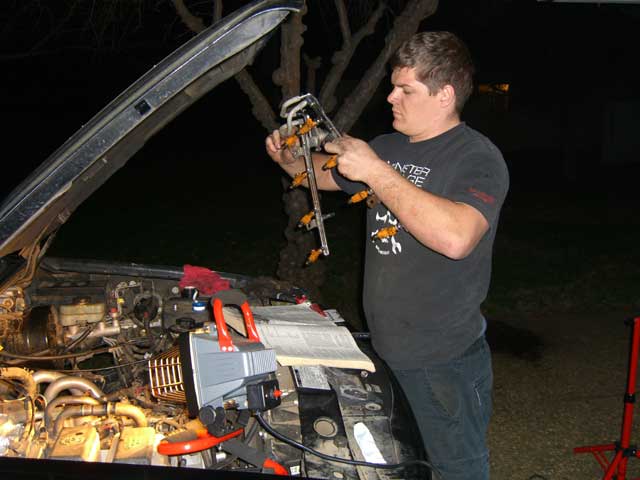

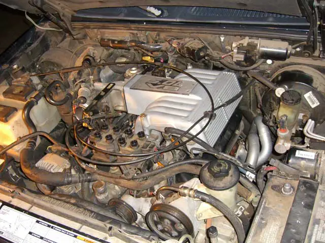

My first explorer and it's sure a project. Section525 and I are screaming along on it. Hope to go pick up some chicks tonight! :exp:
Yesterday:
Today:

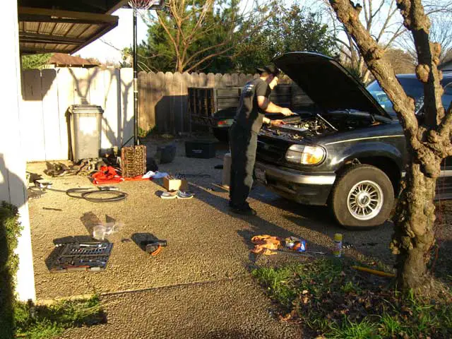

Head gasket. We just got the heads off. Now we're cleaning everything before starting to rebuild it.
It's a '97 with about 133k on it. Tan leather, sunroof, all the good stuff. I think the air ride may be messed up, but that's another project. We picked it up for pretty cheap and hope to only throw about $200-$300 into it.

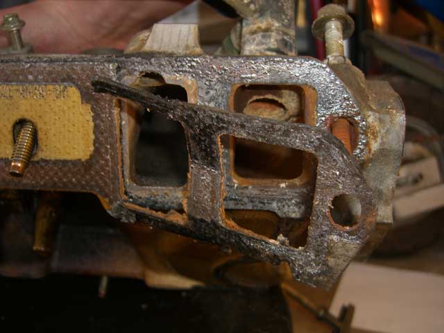

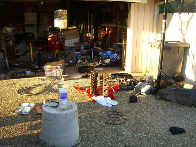

It's down to the short block now. This is what we're dealing with. Looks like we'll be getting the heads check tomorrow. :( Gaskets looked fairly good. So it's better to get them check than reassemble and have the same problem.
Might have to get some AFRs for this thing. Hmmmmm. :cool:

I don't know whats worse - the gasket or the "shop" haha cool deal though. good luck on it

We're thinking there was a problem between the lower intake and the passenger side head. Looks like coolant may have been getting into the block from there. We'll see what the head guy says tomorrow. So we had to wrap it up early tonight. :(

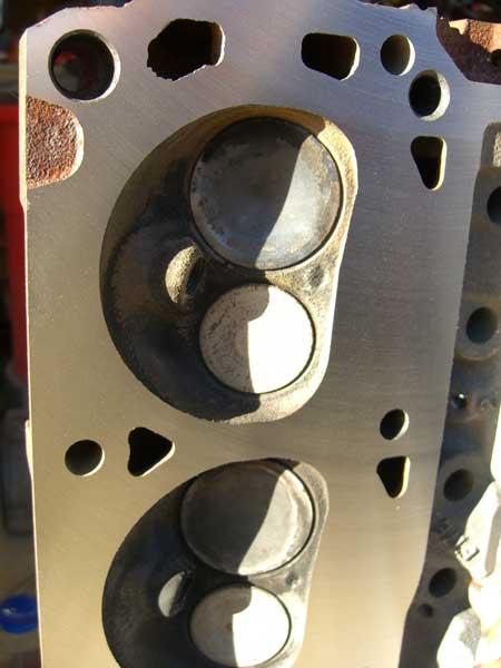

Well, both heads are warped! :cool: :p
We dropped them off and the machinest is resurfacing them and cleaning them. Only setting us back $100. Not a bad deal at all. :D

I don't think they took off enough to effect it much. He told us, but it was all in another language to me. :D
