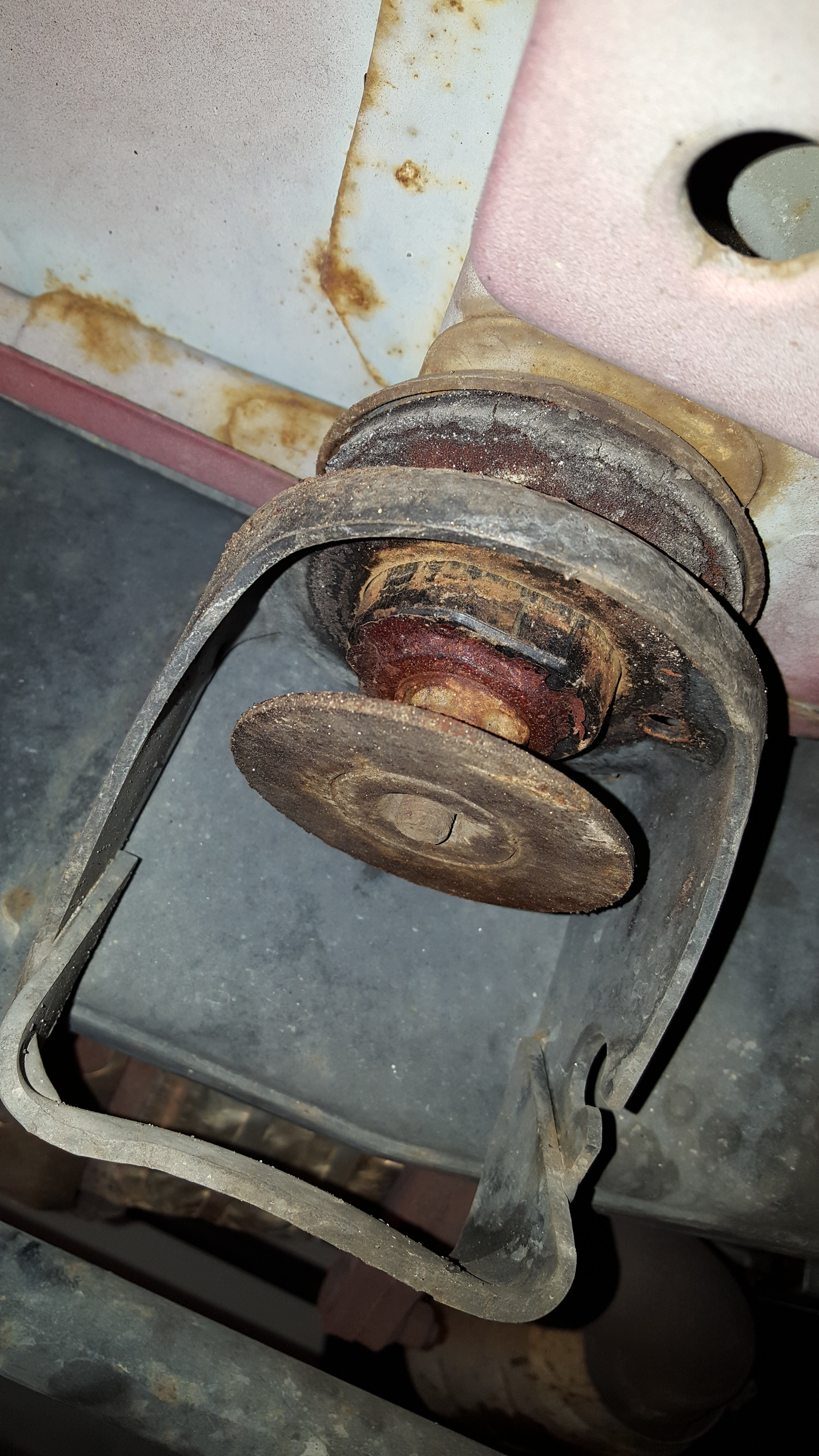

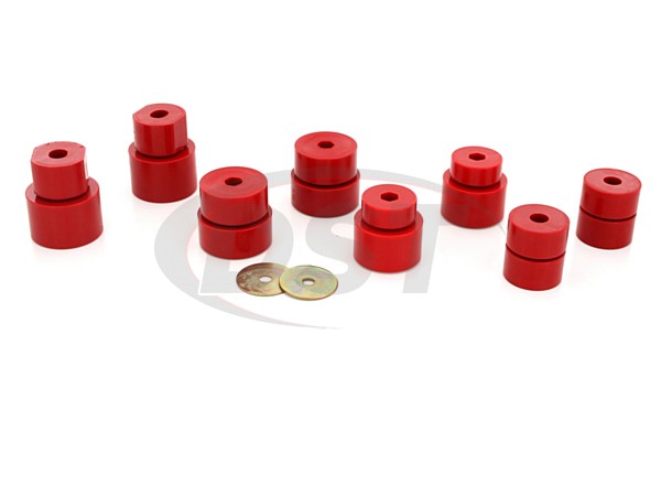

I replaced 2001 Explorer Sport Track body mount bushings. The bushings had deteriorated to practically nothing. I replaced with polyurethane bushings that fit great. I recommend using an impact wrench. I purchased a Craftsman Impact Wrench, worked great. Probably would not have been able to get old bolts off without it. Also had to use pretreating oil as the bolts were rusted through.

Did you torque the bolts to the recommended settings? (41 ft lbs for the "A" bushings and 59 ft lbs for the others). That seemed awfully tight and was actually a bit hard to do, but if you don't you'll get clunking. I found the "A" bushing's metal washers were too thin and were bending under the touque, so I doubled them up with the original OE washers. I still need to go back and re-torque the bolts, as recommended in the instructions, but they seem fine.
