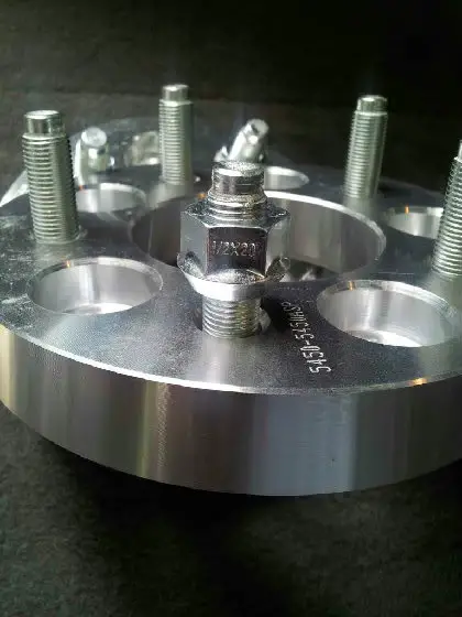

Make sure if you do decide to use spacers, get the good bolt on ones. The slip on cast aluminum or steel ones often aren't hubcentric and will cause lots of problems. There are also crummy bolt-on spacers. If you can judge the quality of aluminum that will help; you want a set of machined aluminum ones (look for tiny grooves) and not cast aluminum ones (suspiciously smooth). Cast parts can crack and cause a bad day.
I got a great deal on some Sport Trac wheels for my 1994 a while ago and found out that the difference in offset had them tucked in dangerously close. I bought the good quality bolt on spacers and at $150 for the full set, it wasn't cheap but I know they will last and I won't have any problems with them. They are as valuable as a good tool in your toolbox if you're keeping the car.
Just got these, $48 to my door, 1" thick - you may want 1.5" on back...
The size & offsst should be cast into the back of the wheels - if it's 24, 25, or 26mm,, tjen it's the same as pre-'05 Mustangs, and the 1"/1.5" combo should look good.
