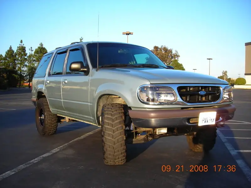

depends on your budget, what you can do/tools, and what size tires your want to run. like i said im running 32's with just the torsion twist (TT), and the rear i have Add-A-Leafs (AAL's) and longer spring shakles (i made customs, warrior makes some WAR-153 and autozone sells a cheap knock off). with my setup the tires look good, but the front rub when you turn all the way or hit pot holes. i had to remove the plastic skirting below doors and the little piece at bottom of front fender, cut the front plastic skirting on front bumper, then i took a hammer to the corner of the fender and bent it in a little bit. do some searching you will find a ton of information. you are 4x4 correct? i can send you some links to stuff if ya want.
