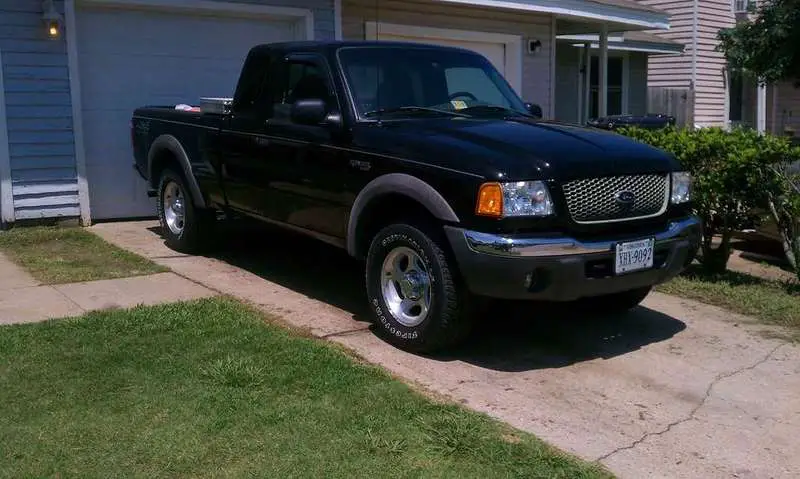

I picked up a 2001 Ranger extended cab 4x4 with a 3.0 with a missfire and a bad oil pan leak leak. Needless to say the gutless 3.0 needs to go. I have a late 97 Mountaineer parts truck I am using for the swap. I will be using the 97 computer so I have to swap the entire fuel system, no pats and shouldn't have too much of an issue with the speedo. I do realize most of the wiring is different from the 2 trucks so there will be a ton of re-pinning on the connectors.
I was set on leaving the truck stock height and doing the V8 swap but have decided its much easier to do a swap with a body lift. Since I did a body lift I realized I wanted more so also going with a 4" superlift kit with coil-over conversion. Will be running 4.88 gears with a lunchbox locker in the front and E-locker in the rear explorer 8.8.
I am a very busy person and will try to update this post more than once a year since this is a slow going project haha
How it started:

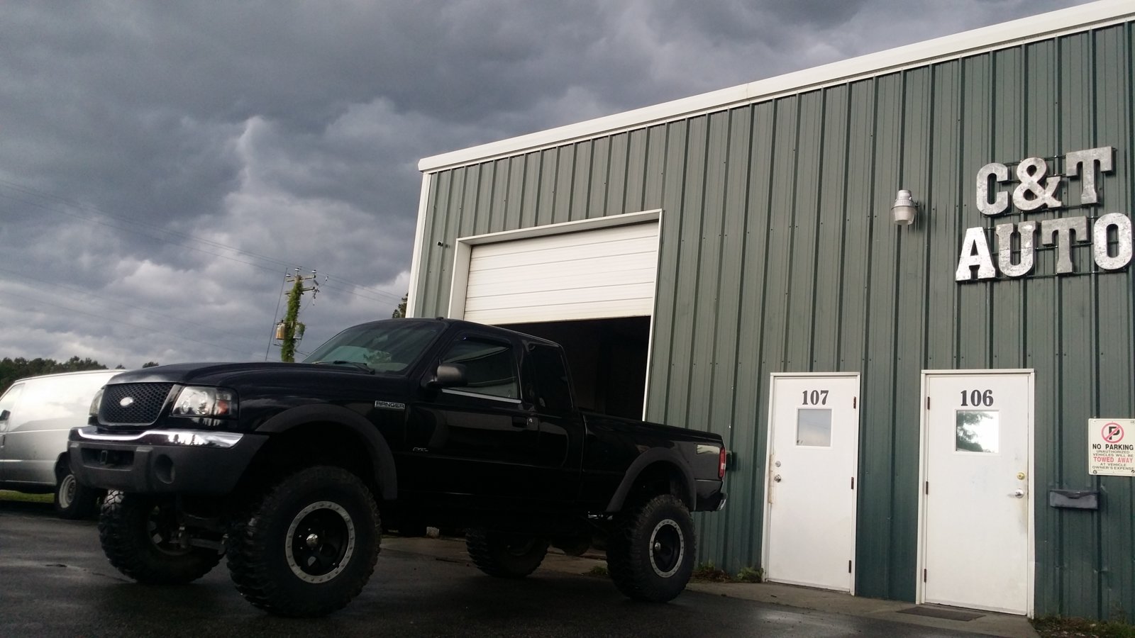

My poor man's deavers haha. Gained 4" of lift using 2 sets of stock explorer springs. Nice and soft still too, flexes great. Still need to swap out the rear axle and take out the factory blocks though.
Are you gonna do manual hubs?
Nope, just going with a torsen l/s in the front.
Finished my rear shock setup and gave it a flex. Have 5" up travel and 6" down.
Badass!

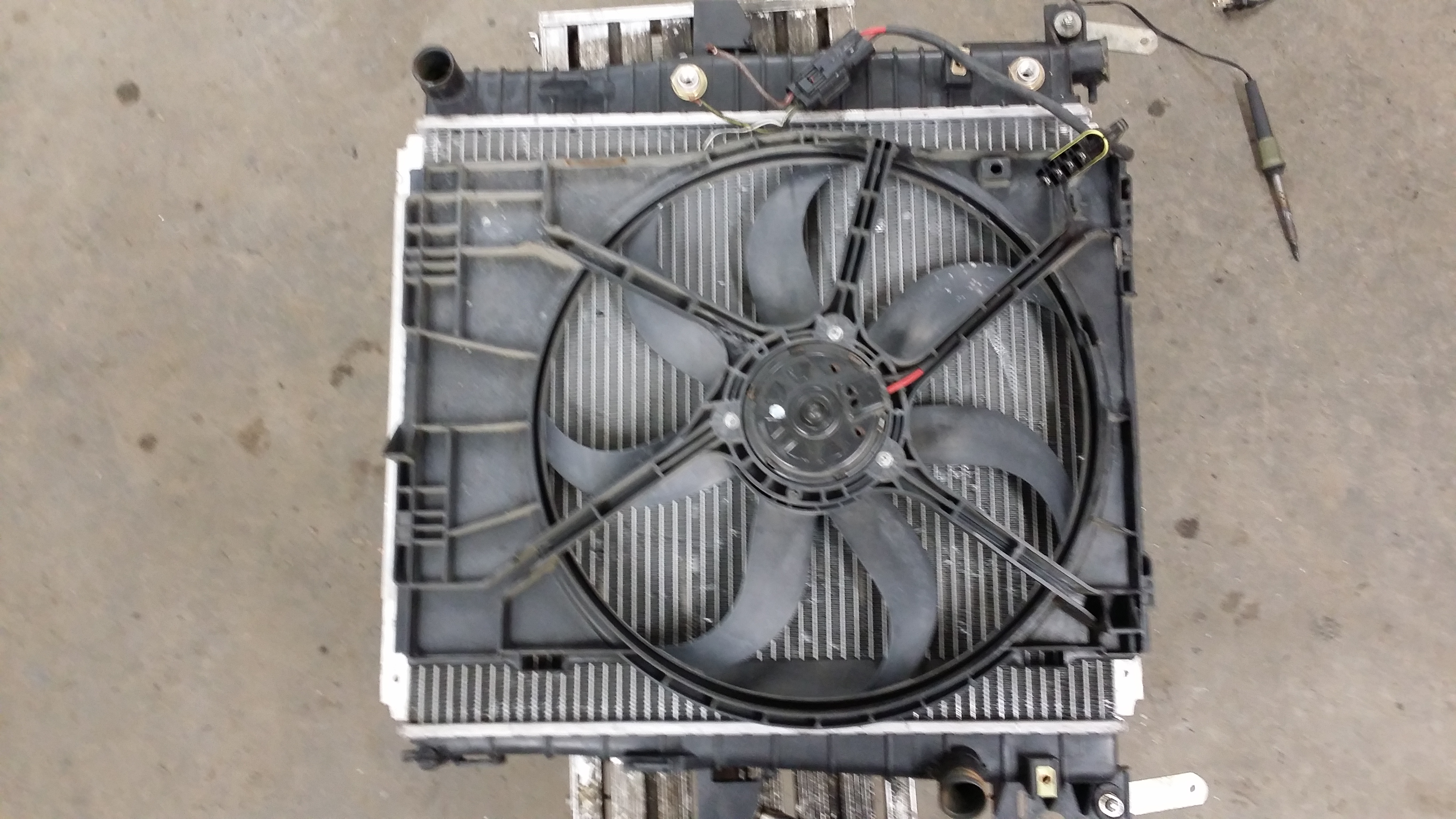

I'm running an E-fan with the radiator in the stock position(not dropped like you normally would with a body lift). I'm using a 2010 ford fusion fan with pulse width mod control (gives 4 speeds)
Very nice work!

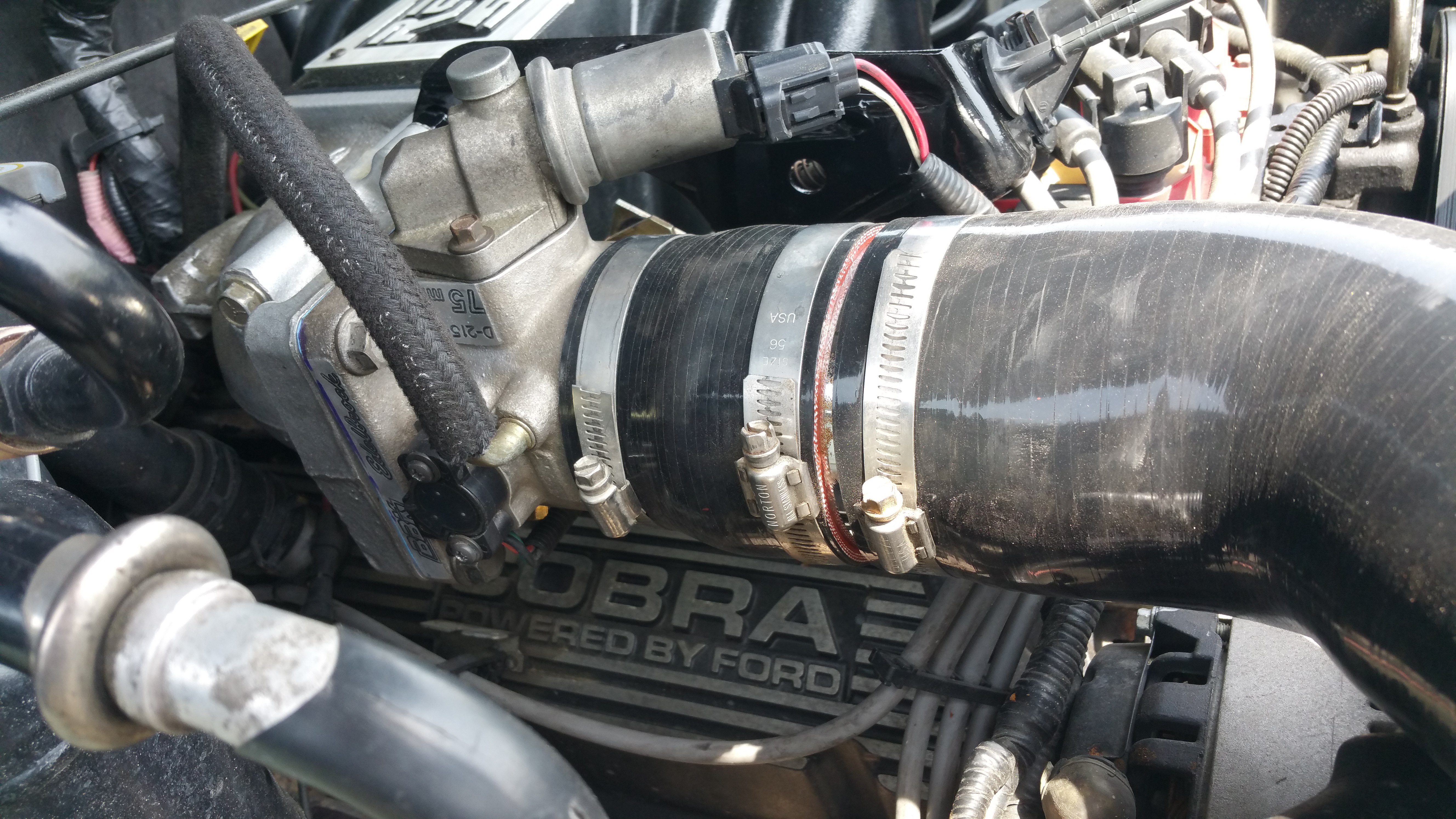

I've actually been daily driving it the last 3 months because I like driving it so much. The low end of the v8 along with it screaming exhaust note to 5800 rpm make it very enjoyable to drive. I've done a ton more to it than what I've posted, time has me limited.
75mm tb w/3.5" intake
