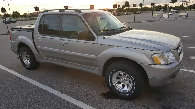

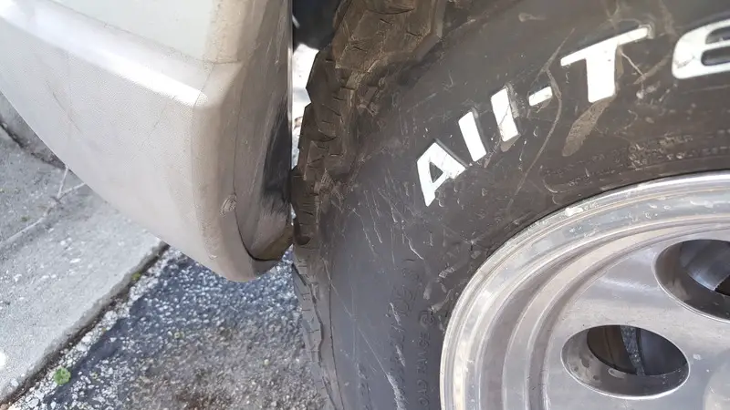

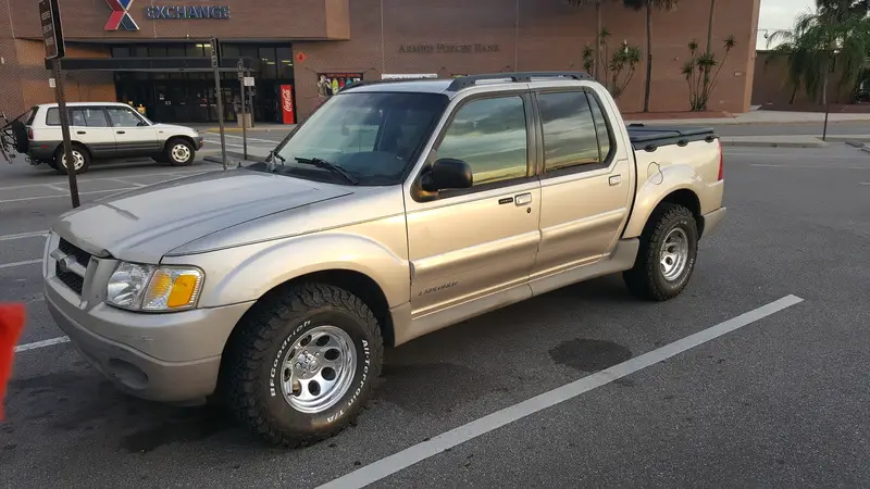

15x8 on BFGoodrich 31x10.5 at stock height.
Note: This truck hit something on its front left side under previous ownership.
The front left wheel was grabbing the inner edge of the front bumper hard and it was a lot worse with the wheel turned to the right while in reverse. I've trimmed away a lot of the plastic where it was grabbing. MOST, but not all of the tire rubbing is gone. On the front right there was no rubbing at all. Soon after these pictures were taken I cranked the stock torsion bar bolts 1 and a half turns from stock height. The front left still rubs when moving in reverse while the wheel is turned to the right.
I'm sure that if this truck had not hit something there wouldn't be any tire rubbing.

If "This truck hit something on its front left side under previous ownership." have you had the front end alignment checked?
With 31's on my 2005 ST I get rubbing on turns - some Dremel work on the fender liners was needed.

Where you'll need to be careful is with the weights. On the front left tire on mine the inside weight was a flat stick-on and the caliper peeled it right off right after I put the wheel on. Thankfully there is no noticeable imbalance as a result.
To Fredness, my front end was aligned less than 2 months ago just before I put these wheels onto my truck. I chock it up to the body parts on the left being pushed back from whatever it hit. All of my front end components have been freshened up over the last year with the addition of camber kits on both sides and replacing the passenger side 2pc upper arm with a 1pc. Moog arm.

Wow so if you rub with 15x8s I'm assuming I'd rub ALOT more with some 15x10s with the same tires.

The worst of the rubbing still happens when I'm in reverse with the steering turned at full right.

About how much do your wheels and tires stick out past the fenders?

They don't stick out. I don't like the look of wheels sticking out. I like them flush with the fender edge. I like best for the wheels to fill in most of the wheel well. The stock 16x7 rims remind me of when a little girl with small feet wears a big dress.

Hahaha do you know how much backspacing your 15x8s have?

-27mm offset
