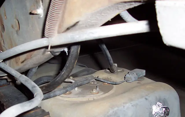

However, it could be part of the intank fuel pressure regulator. The hose above the fuel pressure regulator could be split allowing the fuel to leak back into the tank. For many older Volvo models with low pressure fuel injection the entire fuel pump assembly must be purchased to fix a bad check valve. Because of the expense and trouble some Volvo owners install an external check valve which is easy to do since there are accessible hose fuel lines at the engine. The only external hose fuel line I'm aware of on my 2000 Sport is the one between the fuel tank and the rigid fuel tube mounted to the frame rail.
It is not easily accessible and not a good location for a check valve.
The fuel tank must be lowered to access the fuel hose.

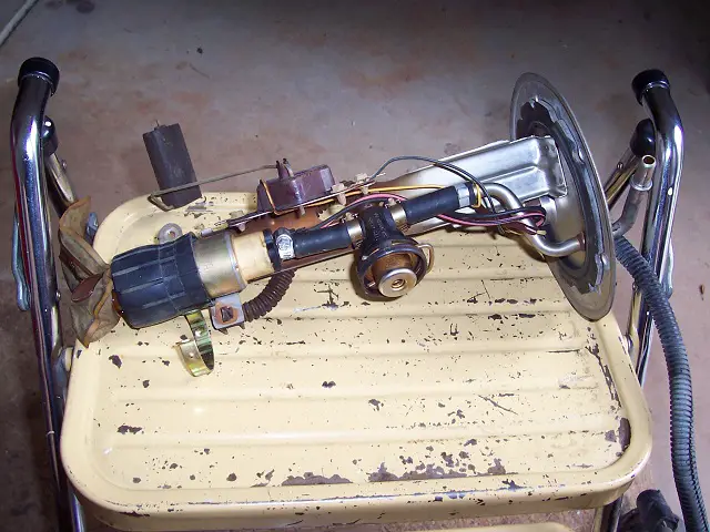

as far as i know, the check valve and fpr are one in the same and are part of the in-tank fuel pump assembly (the round black thing with the silver cylinder sticking out of it in streetrod's picture). it is not available separately. it only comes with the fp assembly. you should have bought the hole fp assembly and not just a new pump, as your pump seemed to be working as designed. if you don't want to spend the $150 now, i suggest you get an assembly from the salvage yard and hope it's a good one.
