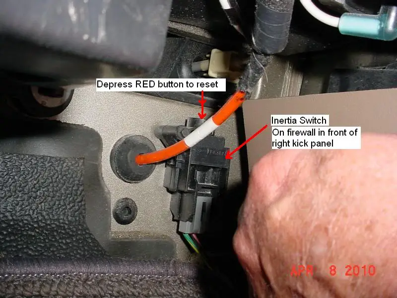

If you turn the switch on and it doesn't make the whirring fuel pump sound then its either the relay or the inertia switch, which is right under the the heater box on the passenger floor. The inertia switch is known for giving intermittant problems. Next time it gives you a problem cranking just smack the switch real good and mash the red button a couple times and see if you get fuel pump noise. You can do this with the switch "ON" and see immediately if the problem is there. Let us know how that goes.
Thanks for the reply! I've been crawling around the truck a bit today trying to figure out what the problem is. I did smack around the inertia switch and the button popped while doing that. I pushed the button back down and still the truck doesn't start. I check for voltage at the inertia switch and I'm seeing 11.9V. Does this rule out the Fuel Pump Relay as a possible problem? I did switch the horn relay and the fuel pump relay to test that also...still no dice.

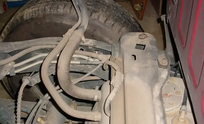

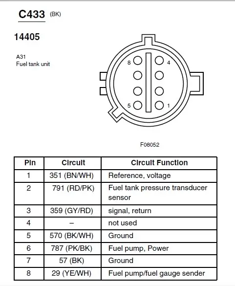

I went under the truck to find the connector that connects directly to the fuel pump, and I think I found the right one. It's right above the rear axle on the drivers side. I disconnected the connector but I'm unsure as to what pins to check for power to the pump. There are 8 pins if I'm not mistaken.

Do you know which pins to check for voltage to the pump? Or a possible diagram? I have the Haynes manual but it's not quite helpful in this matter.
PM me your email address and I'll send you stuff.
EDIT: You have mail: Connector pin-out, schematic and diagnostics sent.

Okay, so I checked some voltages based on a diagram that ncranchero sent me (thank you!)
PIN:
1 - 5V
2 - 5.02V
3 - 0
4 - 0
5 - Ground
6 - 6.67V to 11.98V
7 - Ground
8 - 11.98V
IIRC: Okay, when the key is initially turned on, I get 11.98V from pin 6 for about 1 1/2 seconds and then it goes to 6.67V constant. The reference voltage (pin 1) stays at a constant 5V and the Fuel pump/gauge sender (pin 8) is also a constant 11.98V.
So does this seem okay for voltage to the fuel pump? An initial 12V and then cuts back to 6.67V constant after a second or two? Needless to say, the pump still does not kick on after I reconnected the connector.
If all things point towards bad fuel pump, which appears it does, I will move in that direction.
The voltage drop-back is done to pressurize the system and IF it would crank it would go back to 12 +/- volts. I believe it time to replace the pump. It would be nice if the Sport Trac was like the F150 and you could just slide the bed back to replace the pump but no such luck.
If you remove the left rear wheel and the fender liner you "may" be able to disconnect the fuel filler neck hose and siphon the tank out. Never tried that but it's worth a look.
