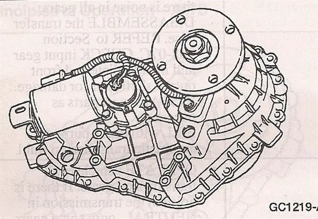

Here are a couple of pics of the transfer case shift motor from my shop manual. Hopefully it will help:
Worth a shot to check out. Good Luck. :D:thumbsup:
