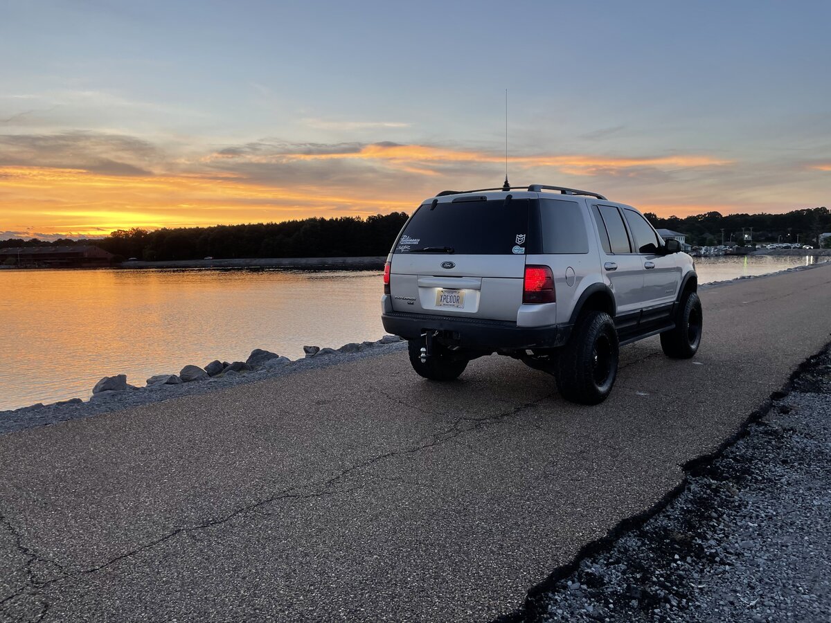

I have a 2002 Ford Explorer XLT with a 3” body lift, 3” suspension lift, and 35 in tires. My explorer has started to rock real bad side to side going 65+ after every bump. I have extended beefed up sway bar links front and rear, I replaced my rear struts and that made it go away for about a month, and now it does it again. It is extremely dangerous and I have a road trip coming up in a month! I’m thinking now that I should replace the front struts and see if that fixes it, I really don’t want to be throwing money at it and not solve the problem! Has anyone else had this issue?
