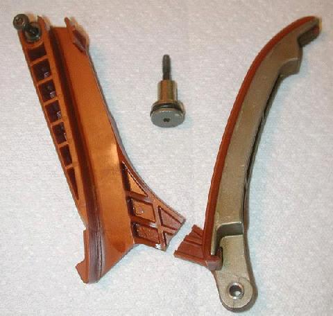

SOHC V6 timing chain related issues
Timing chain related component failures apply to all Ford 4.0L SOHC V6 engines installed in Explorers, Mountaineers, Rangers, and Mustangs. Improvements to increase reliability were incorporated in engines installed in 2002 and later vehicles. Unfortunately, the traction side of the right cassette guide assembly was never reinforced with metal so the plastic can still break from fatigue.
When this guide breaks the engine or transmission must be pulled to replace it. Using synthetic oil and a quality oil filter with good flow and anti-drainback valve may increase the life of the components.
