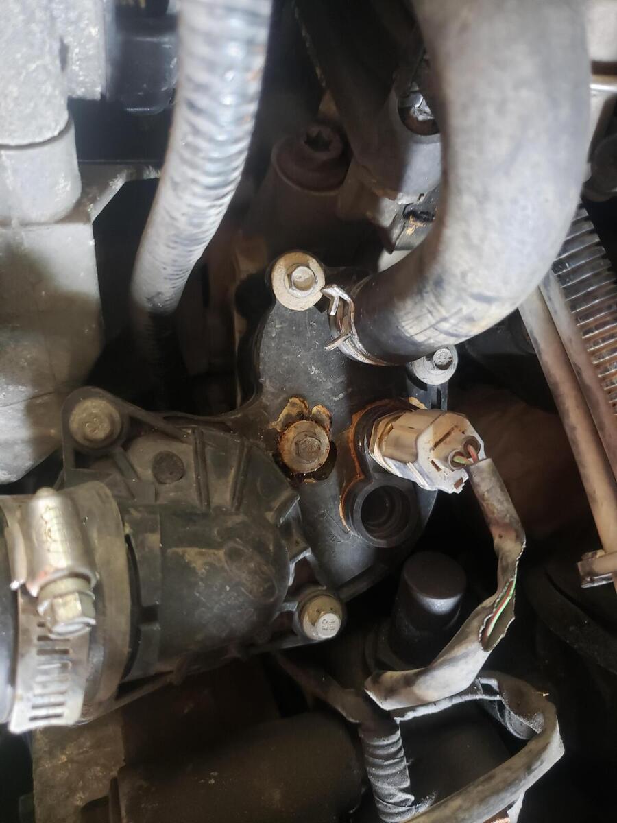

Looks to be leaking from the middle bolt on the tstat housing. I checked the bolt and its tight. Any suggestions on how to fix this?
Check the other bolts how they get sealed (maybe the mechanic lost a washer or something else) otherwise you could try an o-ring. If the housing is cracked i fixed mine with soldering the plastic, clean it really good (als use sand paper) and then i put some jb weld epoxy on it. I did the epoxy fix one year ago and it still doesn't leak at all. Btw the water leak could also be coming from the sensor, i know for sure that there are 1 or 2 o-rings in there, maybe the mechanic lost it...
Its definitely coming from under the bolt. With the car running you can see the water slowly oozing up from around the bolthead. Looking at a picture online, it would appear that bolt shouldn't be coming in contact with coolant at all, which means the thermostat housing must be buggered and leaking internally...?
I'm not going to bother with trying to fix this housing. It was bought used in the first place, and didn't leak until now (but the coolant system did get pressure tested twice in this week) so I'm just going to replace it. Already ordered a replacement from RockAuto.
