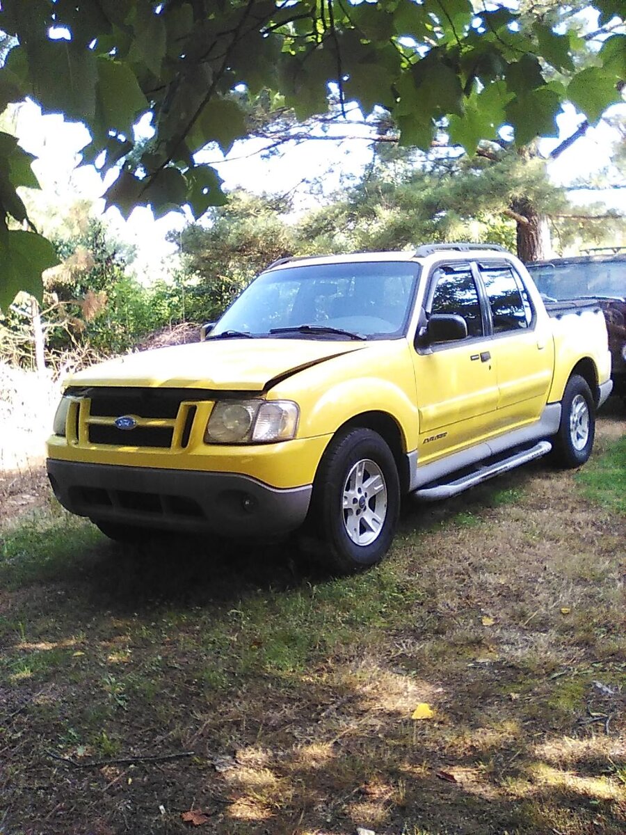

I remember when these were new and i said "What is that?" We haven't settled on a name however "Big Bird" and "The Yellow Submarine"
are the top two names that have been discussed. The Beatles "Yellow Submarine"
I'm not sure if it is a 2002 or 2003. Here is a picture of the VIN plate.
It was built the 8th month of 2002. That is so late in the model year that I don't know if it is the last of the 2002s or the first of the 2003s.

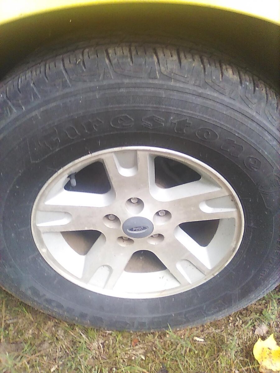

Below is a picture of one of the new Firestones. How much do a set of these cost mounted and balanced?

The title will tell you what year it is, assuming you have it. My '02 also has an 08/02 Build Date. The ETIS report says it was built on Aug 1. I don't know when they switched from '02s to '03s. '02s had an analog dash while '03s had the digital dash. The Sport Trac emblem on the tailgate in '01 & '02 had a red background with white letters, while the '03-05s had a silver/chrome background with black letters. '01 & 02s had rear drum brakes. 03-05 had rear discs. Those differences might not mean much if they mixed parts during the transition.

@429CJ-3X2 Look at my VIN tag in the picture above and tell me which digit in the VIN says what year it is. I have had several Alabama titles that have had mistakes that surprise me. The most surprising was one that the VIN had one digit different than the vehicle. It was really hard to convince the officials to correct the title disinformation.

OK. I must have a 2002. It has the red tailgate emblem.

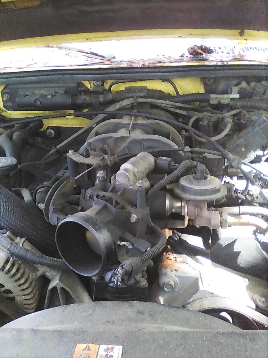

The big issue at the moment is, where is the Schrader valve on the fuel rail or where is the fuel line up near the engine?

I don't know how to read the VIN, but a quick internet search confirms it's a 2002. 1FMZU67E32UD***** VIN lookup for 2002 FORD EXPLORER SPORT TRAC
Despite my truck also being built in 08/02, our VINs are way off, but maybe because mine is 4WD and yours is 2WD?

Does the fuel line come up the spine of the transmission?

Somewhere between 02 and 04 Ford stopped installing the Schrader valve and ran the fuel line up the spine of the transmission? I guess it was late 02 since your sohc does not have one. That is why I asked if the fuel line is up the rear of the trans

@410Fortune Here is a better picture of the intake

Don’t the later 4.0s not have the fuel
Rail shrader?
Fix4Dirt
Get a Load O' This Guy!
December 22, 2021
3,192
1,479
Los Angeles, CA
1998 XLT 4x4
Rail shrader?
im probably wrong but i think ST didnt have one. also after 05 maybe around they were deleted from the 4drs too. they had pressure read to the computer, not you reading pressure iirc.
410Fortune
Truck Season!!
Staff member
Moderator
August 3, 2000
28,244
4,163
NORTH IDAHO, 7B
B2 "Slightly" Modified
Callsign
FOURTEN
that engine should have a shrader valve, I am sure it was after 04 when it went away and the fuel line moved to the spine of the trans
Look near the drivers shock tower, should be a single fuel line over there

OK. I finally can see a single fuel line under the driver's fender and it has a quick disconnect on it behind the PS pump. I can hook a hose on there to get the fuel out of the tank. It seems like I could possibly hot wire the fuel pump at the inertia switch. Possibly. From the quick disconnect up to the fuel rail is a single line with no Schrader valve. But I don't need a Schrader valve now that I see the quick disconnect. Thanks to all of you helping! These 2002 Explorer Sport Trac 4 door vehicles are new to me and Jamie, didn't you say they are like a 2002 Ranger chassis/frame?, More or less?

well they are wired more like a Ranger then a late Gen II explorer
but the rear springs are still under the axle like an explorer, so it is not 100% Ranger, but very close
You can hot wire the fuel pump at the fuel pump relay (jumper wire) to power the pump and get the fuel out
I just did this yesterday on a 1989 F350 460 truck, we replaced both fuel tanks, jumper wire at the FPR and pumped out tanks till they were nearly dry

OK. Great tip Jamie and other info. When I get the fuel out of this one I will feel a lot better.
