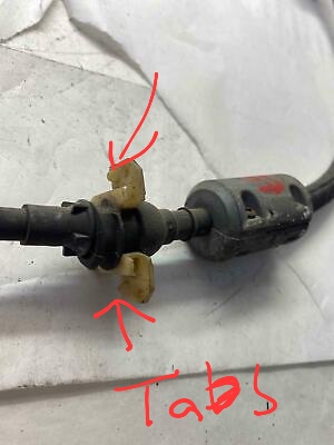

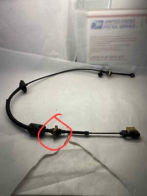

Sounds like something still wrong in the linkage. It may be possible that the linkage has some play in it because they may not have properly attached it. The linkage should attach to the transmission in 2 spots. One at the very end that goes to the actual shift lever on the side of the transmission. The other where the cable attaches and clips into a metal bracket on the side of the transmission. This has a plastic clip with little locking tabs that click to lock it onto the bracket. Make sure it is secured tightly at this point with no movement.

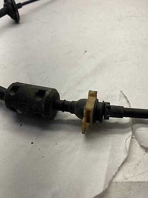

Also, pull this piece off and make sure that the white part does not slide around inside the black part.
