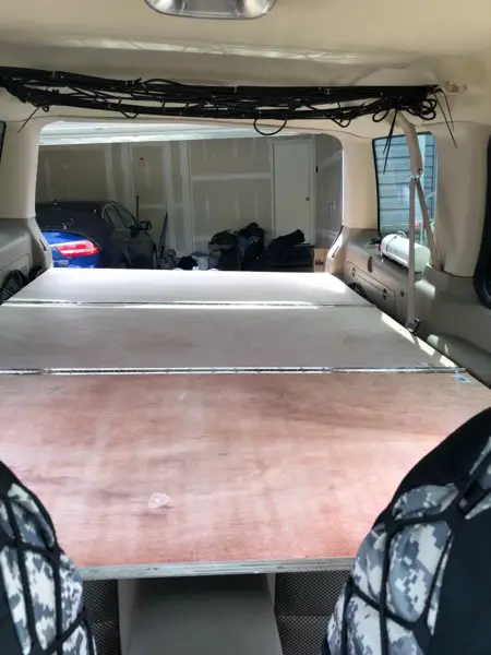

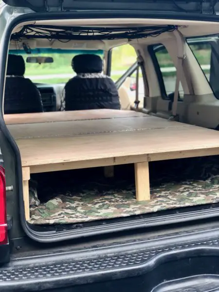

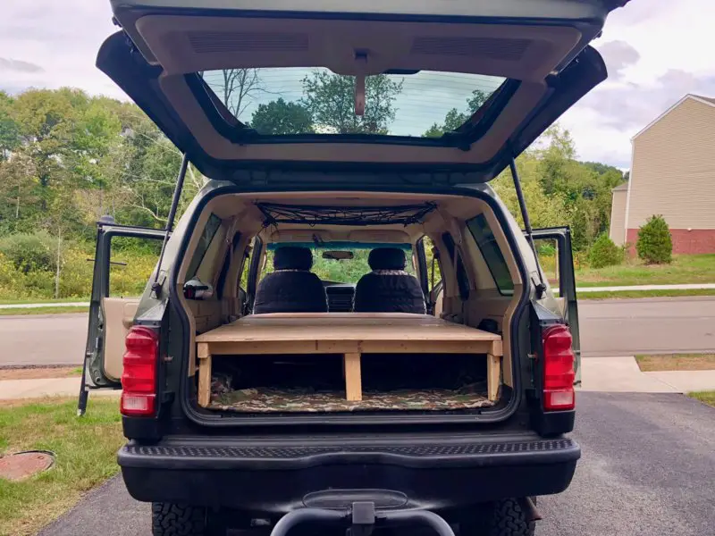

I really like your video. Do you have pictures and dimensions?

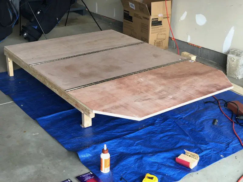

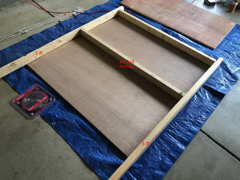

Thanks! Here are some more pics and the dimensions.
Each plywood piece is about 2ft by 4ft, bought them pre cut.
The boards that run the length of the ex are 5ft a piece and they come to right about where the folded rear seats are.
The horizontal supports ended up being 44 3/4 inches in length for all 3.
The legs are a different story all together. Since my cargo area doesn't have carpet anymore they all ended up being a little bit different lengths to get it to work with the bumps and ridges of the floor and then the carpeted area where the backseat is folded. I will say they are all over 8 inches a piece with the exception of the two that fold behind the driver's and passenger's seat. Those ended up being about 20 inches.
