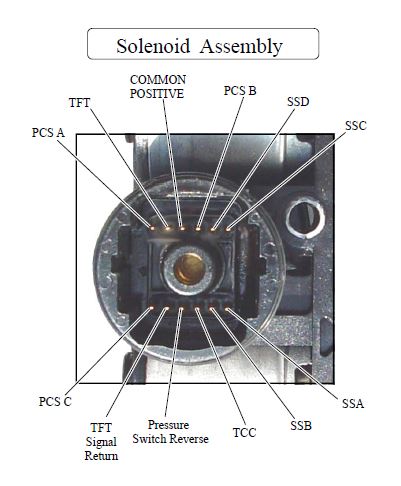

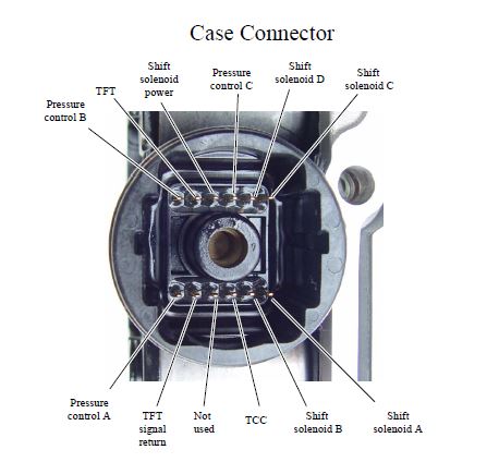

I have a 2003 mercury mountaineer just put a new tranmissison in it and the plug that plugs Into the tranmissison was no good so I bought a used one at a junk yard. I thought it was the same year but I have 3 wires that don't match up.. tranmission is a 5r55w ..NEED HELP THANKS
