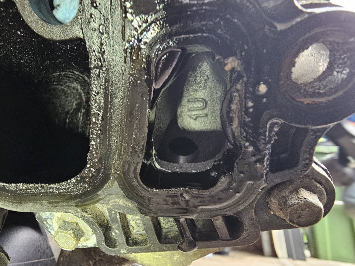

Found a little chunk of the interior coolant passage missing on the manifold around the cylinder 1 coolant crossover. Really not in the mood to buy another manifold but I just know this is going to bite me again if I put this back on.
maybe I can put some sealant around the outside lip there.
*UPDATE - I just ordered a doorman replacement intake manifold and coil boots from rock auto. It just won't be right to go through all this and have it leak again.
