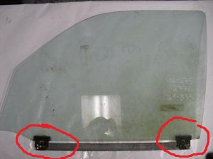

can i glue the window back on the regulator and if so what kind do you recomend ?
if your talking about the part that is circled in red
yes, you can reglue it. you can use urethane that comes in a tube
I re-glued one with 3M yellow weatherstripping adhesive. That was 3-4 years ago.
really? gorilla snot works? that i didnt know! lol
either you can use what koda said, or any urethane for windsheilds that you can find at your parts store
