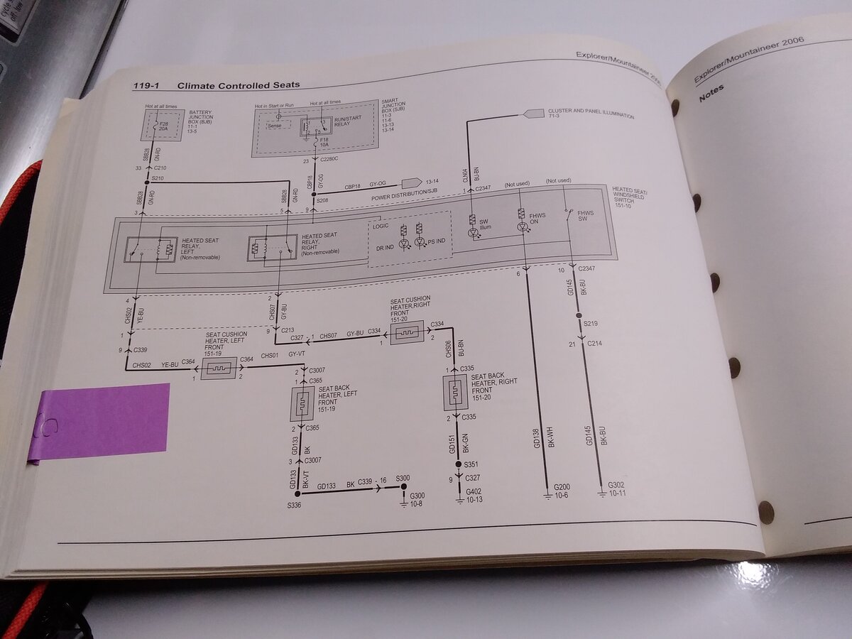

I purchased 2006 Explorer seats to install in a 1956 F100. The seats are heated and all power except the passenger lumbar is manual. Does anyone have a wiring diagram that identifies each colored wire that comes to the under seat connector? I've seen a couple schematics but they are too small to be readable and when enlarged are too blurry to read.
