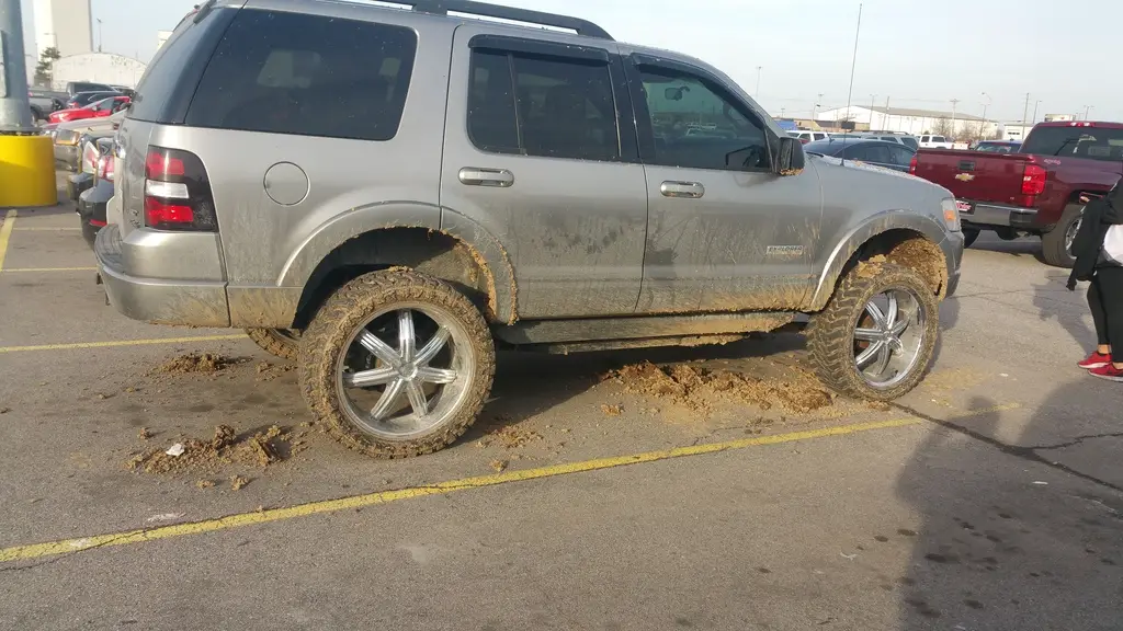

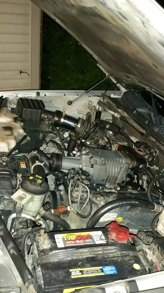

I have an 08 explorer lifted 5.5 inches. I'm running 33X12.50R22 with 1 inch wheel spacers. The wheel spacers caused it to rub at full lock when flexing. It would clear a narrow 35. I have a 20 ft boat and a 23 ft camper, with the stock 3.55 gears and SCT tuner it was to under powered to comfortably pull them very far. I fixed that with 4.10 gears and a supercharger. I probably have as much in my tires and wheels as I do all my other upgrades combined. If you do the work yourself and shop around you can do the left fairly cheap. Your main options are strut spacers, or Rancho lift struts but don't use both, and modifying a Ranger body lift.

Like the saying goes, it's a work in progress. I just have my garage at home and it's far from a machine shop so try not to judge my work to hard. The supercharger setup is still in testing so it's not cleaned up and nice looking yet.
Very nice! My only critism. And only. the body lift is a nice choice but it just leaves so much exposed underneath . if you're going all out why not do an SAS and get it all lifted up? Im going with the strut spacers/Rancho lift struts/ upgraded arms/ and joints it brings to it almost 4 inches . i,know you can't get as much wiggle room with tires but it seems like a safer route without extreme modding. It's really nice though !
Thank you. I considered doing the SAS and using a Ranger suspension lift. This is my DD and I decided to go this route mostly for time and simplicity. I did all the lift stuff last November, since then I've found the weak links..wheel bearings and breaks... I'm still running stock A arms, I will order the tubular one's I've seen on here when mine wear out. My plan is once I get board with it or go to a new DD, I'm going to put F150 running gear and lift under it and ending up with 11 inches of lift. The only place you can really tell it has a body lift is the tail pipe and front inner fenders. The hardest part of it was getting the factory bolts out because of the completely round puck for a nut most of the bolts have. I've read several places not to combine the spacers and lift struts because the struts will compress more and somewhat cancel each other out plus it is to much angle on everything.

Thank you, I did a lot of searching and planning before I finally put this combo together. I'm using Truxxx 2.5 inch spacers and a modified Ranger 3 inch body lift. The MTs on 22s I think are what make the fact it's lifted really stand out. My tires were about $1100 shipped, and 80 to have them mounted. It took 3 guys and a tire machine to do it. 33X12.50R22 M/T 10 ply = 72 pounds of tire and about 1 inch thick sidewalls.
