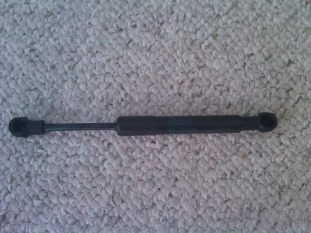

Did some searching first, but no luck. I am sure this has been covered, but pardon me for being a newbie.
In the front of the pick up box there is a storage compartment that goes left to right. To open it you pull a handle that is tucked up under the left side.
The box lid is suppose to pop open and is held open by a small strut...looks sorta like a shock.
Mine is weak and does not work. Went to Ford to get a replacement and list price is $225.00
I can not believe this would cost more that $30.00 and I can not find a after market part. I mean really there is gotta be a gouging law some place.
HELP!

Can you take a picture? I don't have anything in my bed with struts on it.
BTW - no need to apologize for being new, everybody is sometime! Good to see somebody from sw FL too, still spend like 1/2 my year there.
When looking at the rear window from the back of the truck it is on the left side of the hatch when it opens.
It is approx. 8 inches long and 5.75 inches compressed.

Check this "StrongArm" universal gas spring catalog. Looks like the first listing is your choices just don't get them too strong.
StrongArm application
Where to buy.

Thanks to ncranchero post I found the part for $16.00
To answer the other questions is yes I use the storage area, and I liked the idea of pulling the release catch and having the lid pop open. :D

OK here is the skinny. Approx 11" X 40"
Hatch
Release information
Picture of Strut
