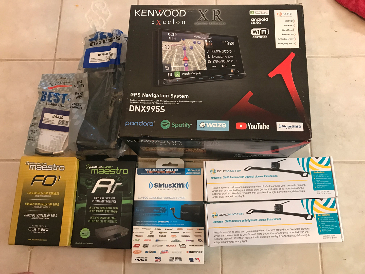

Parts Used:
Kenwood DNX995S
Maestro iDatalink Rr
Maestro FO1
SXV300 XMradio Tuner
BAA20 Ford Antenna Adapter
BKFMK540 Radio mounting bracket
Echomaster Camera CAM-LP1-N (used for front and rear cameras)

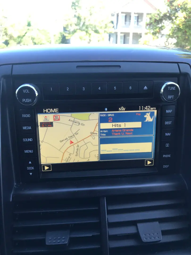

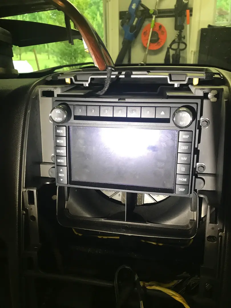

Here is a picture of the lovely stock unit in all its glory:
As far as removing trim pieces this was one of the easiest cars I have ever dealt with. I removed and reinstalled many many panels with little trouble.

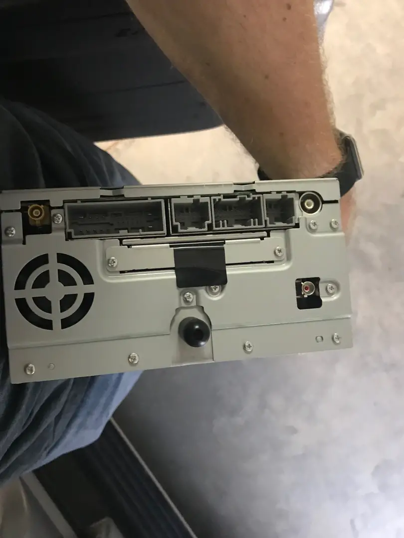

Front and back of the stock unit.

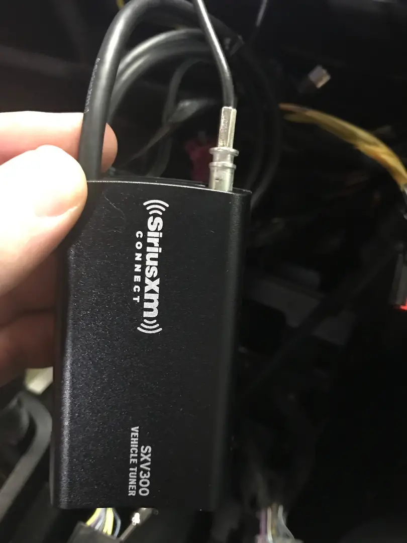

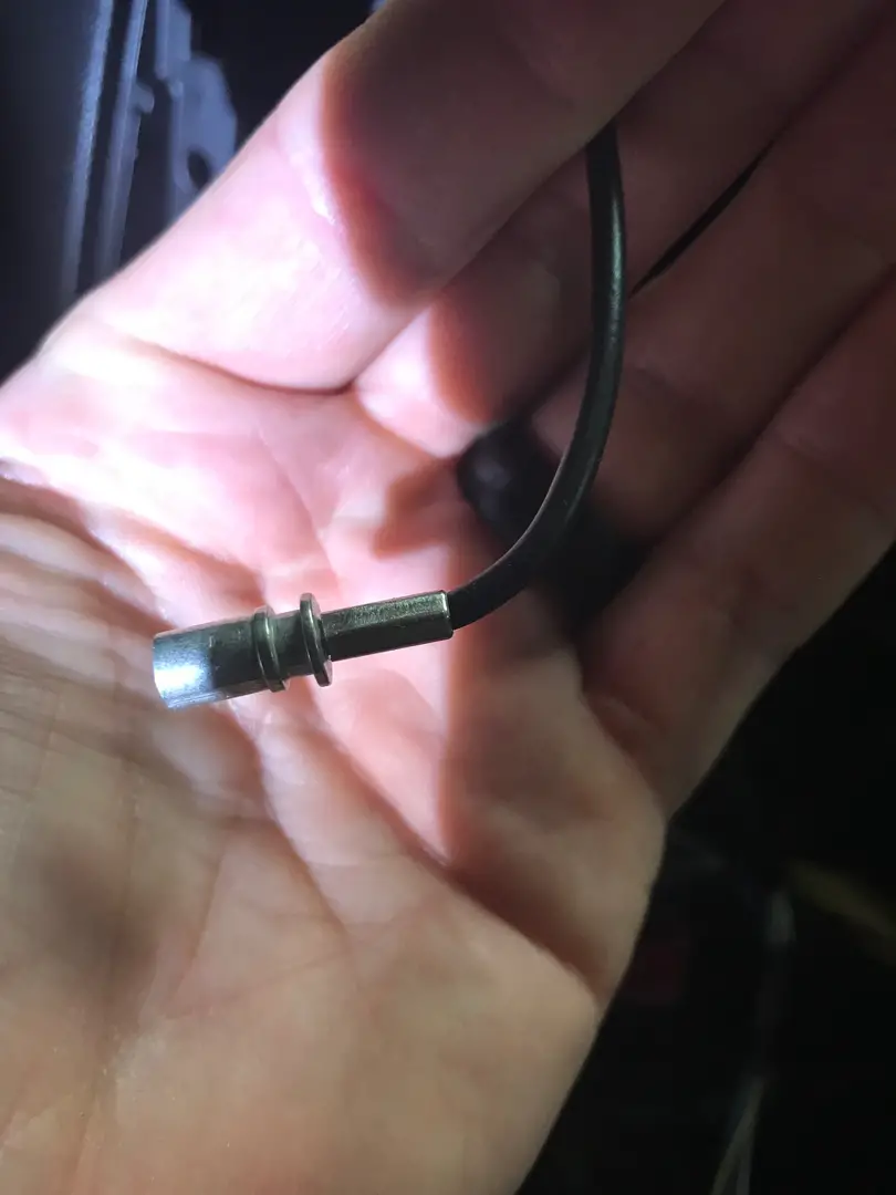

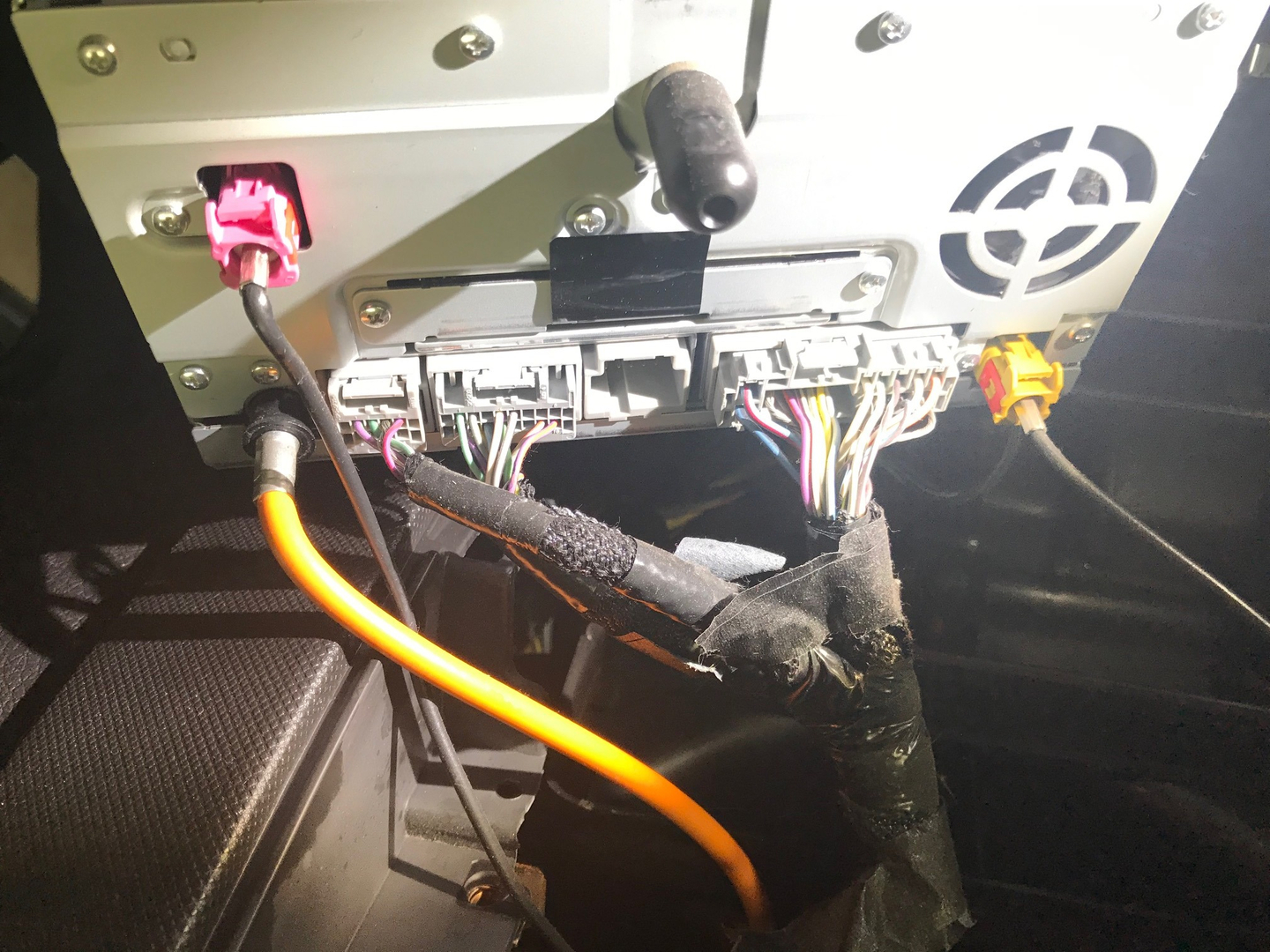

Here are the stock Satellite antennas. Pink is GPS (could not reuse) and Yellow/Tan is XMradio. I removed the plastic clip on the XMradio and plugged into the SXV300 tuner and taped it up to keep using my factory Satellite antenna on top of the car. I could not reuse the GPS one so I added the one it came with and just tucked it up under the blinking red light that has a nice ledge behind the radio.

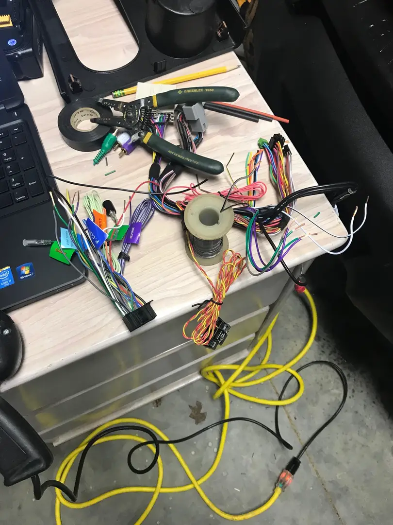

The hardest part was making sure you wired the idatalink correctly.

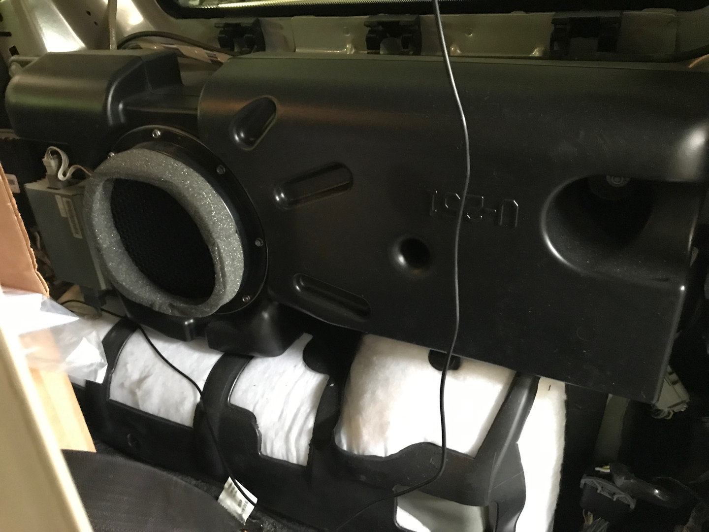

While running the rear camera wire I decided to take off the rear side panel and look at the stock 8" amp. That is a project to come soon.

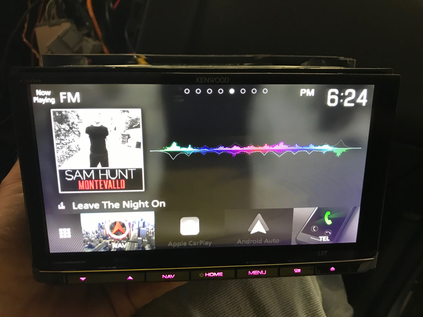

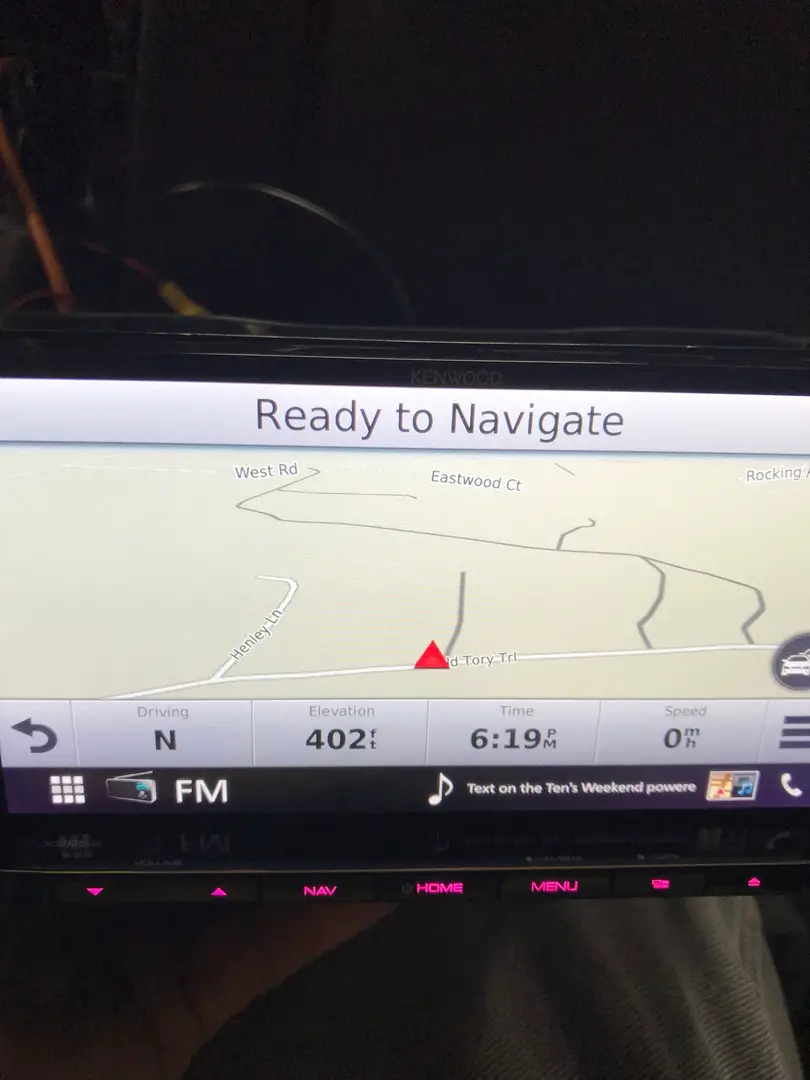

Here it is testing before going back in:

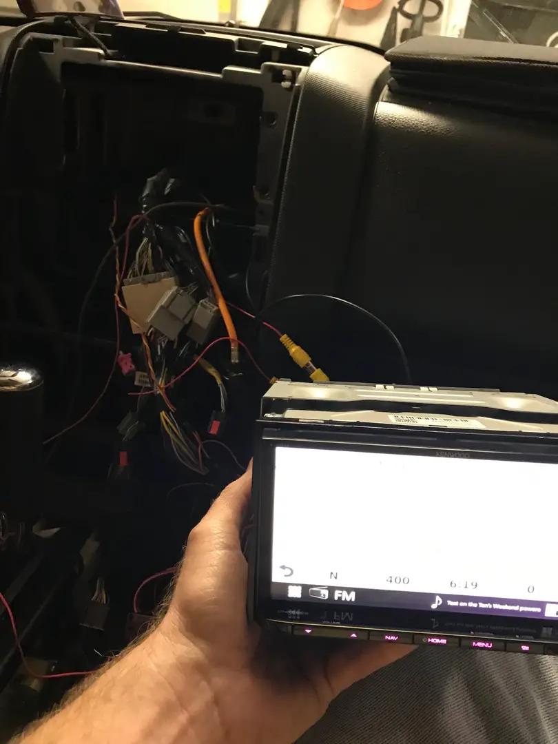

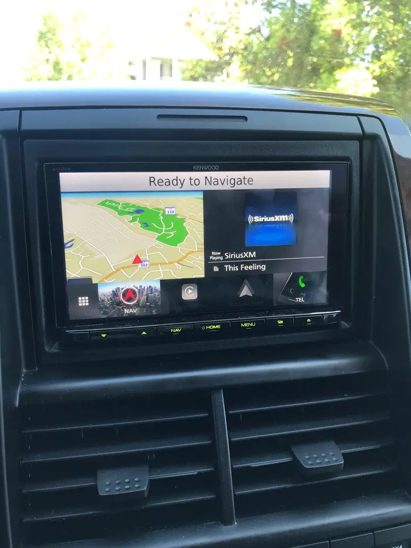

Here is the final fitment:
Overall I am very happy with the install. Still learning the head unit. I did not know the front camera came on when under 5mph and I wired it to the parking lights so half the time I just get a black screen. Need to fix that. The speakers sound much better but still need some upgrades.

How is the front panel held in? Do you have to remove part of the center console?

Under the center console lid is two bolts. I removed them and the rest was just clips in place kinda pull out and up at the same time. After that there is 4 bolts holding the actual radio in place. Never had a car that was this easy.
