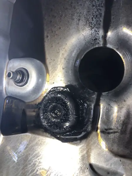

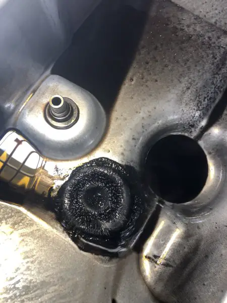

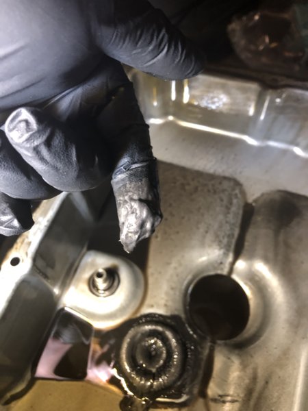

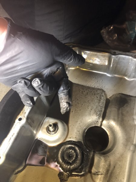

Hello, so i did changed transmission oil an filter and there was no burning smell, but whatever their call it a metal residue on magnet in oil pan.
After i replaced oil and filter all gears started to work and no more slipping but late shifting in 1st to 2nd gear and wrench light comes on after 30 seconds of driving.
Just ordered solenoid pack and will see what will happen...fingers crossed.
Thank you everyone for help and support... i will keep you updated.

With that amount of debris on that magnet I would say you will have to pull that transmission out and have it rebuilt. That is way too much debris.
