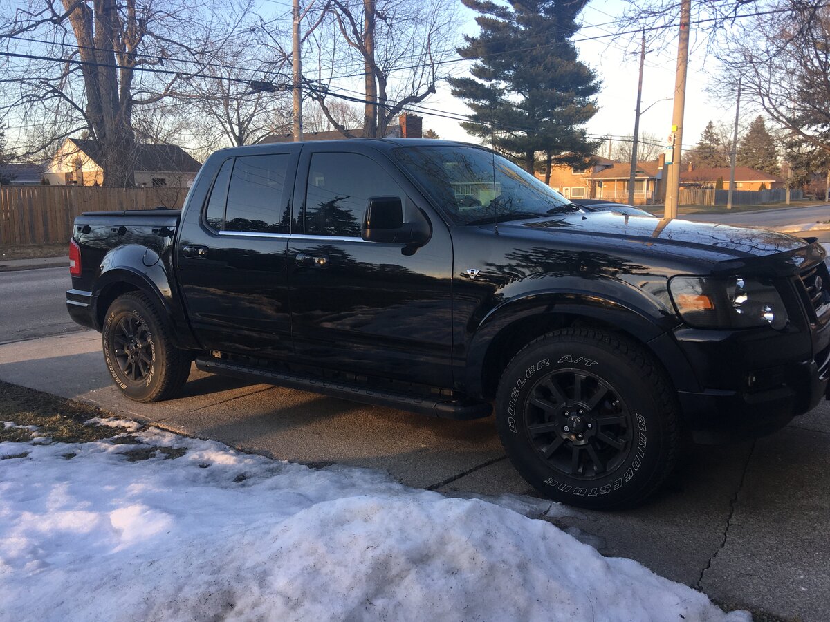

255-70-18 on mine. I use these ones in the winter. I only get a very slight rub somewhere on the front inner plastic fender at full lock. Basically not an issue at all. The truck looks like it should have had these from factory.

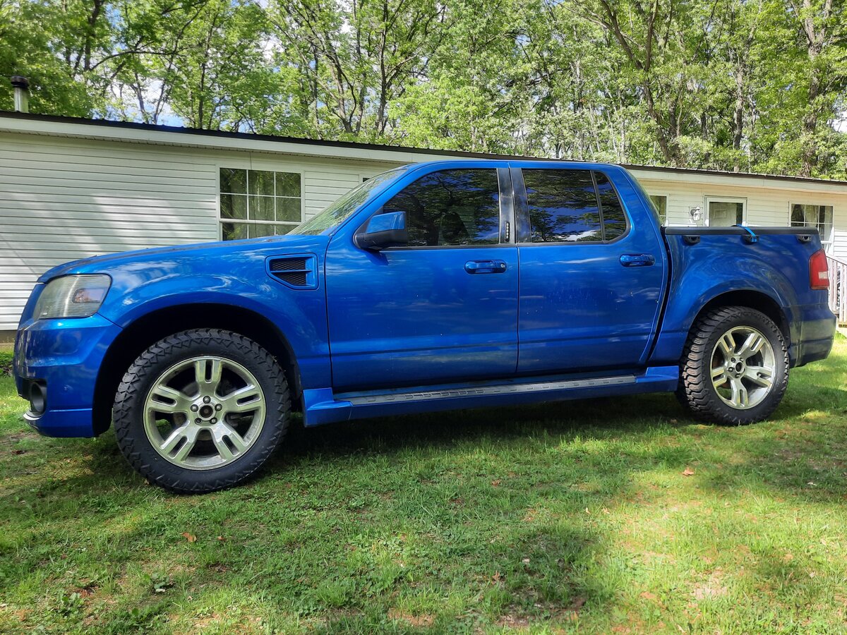

275-55-20, no lift, no rub!
That is an excellent size tire for that truck and the wheels, those are 32" tall.
The OP tires in question will be about 31" tall, varying slightly by maker and tire model.
