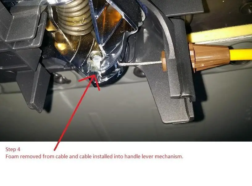

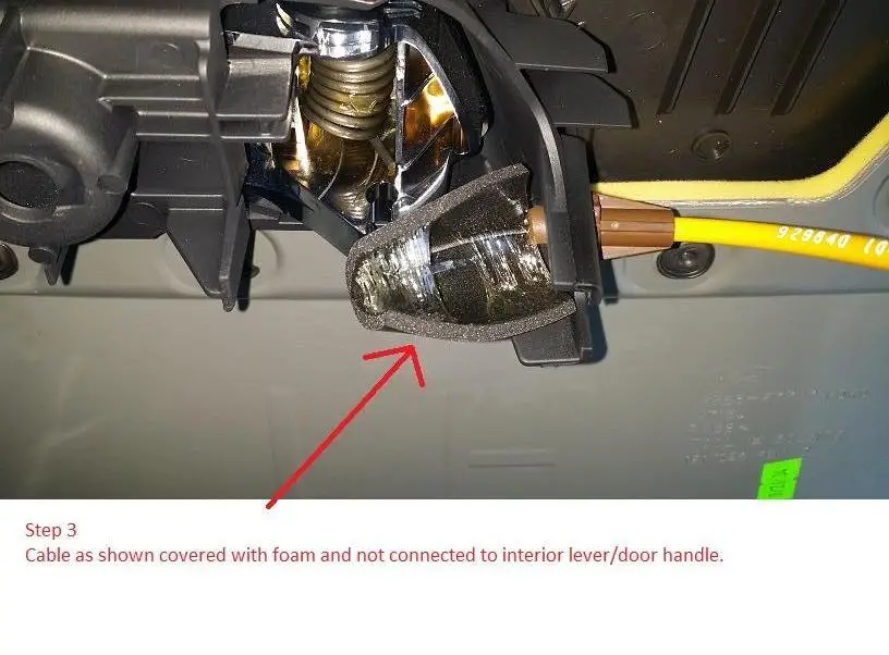

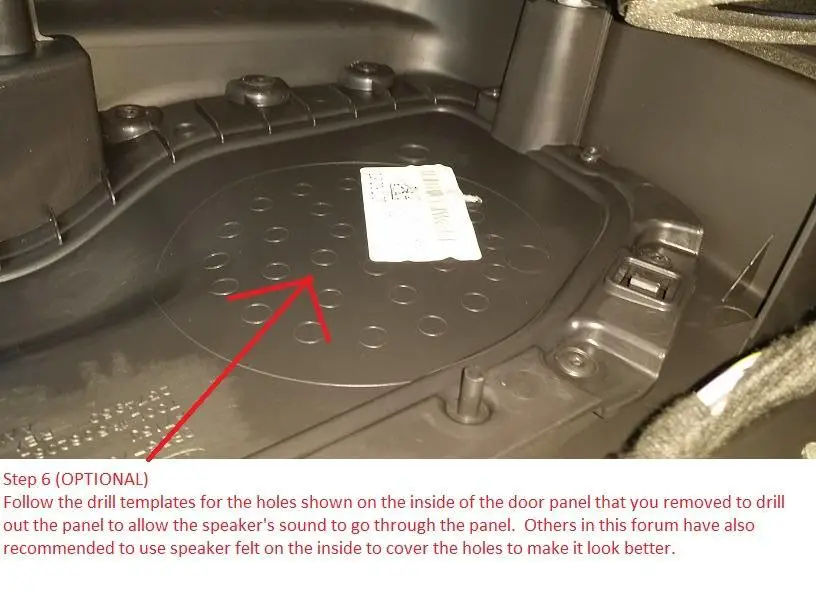

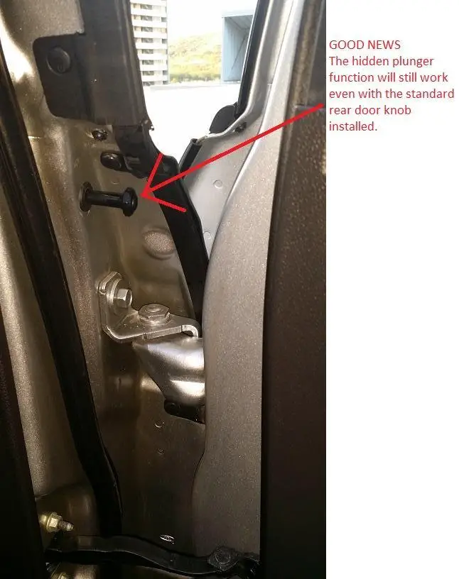

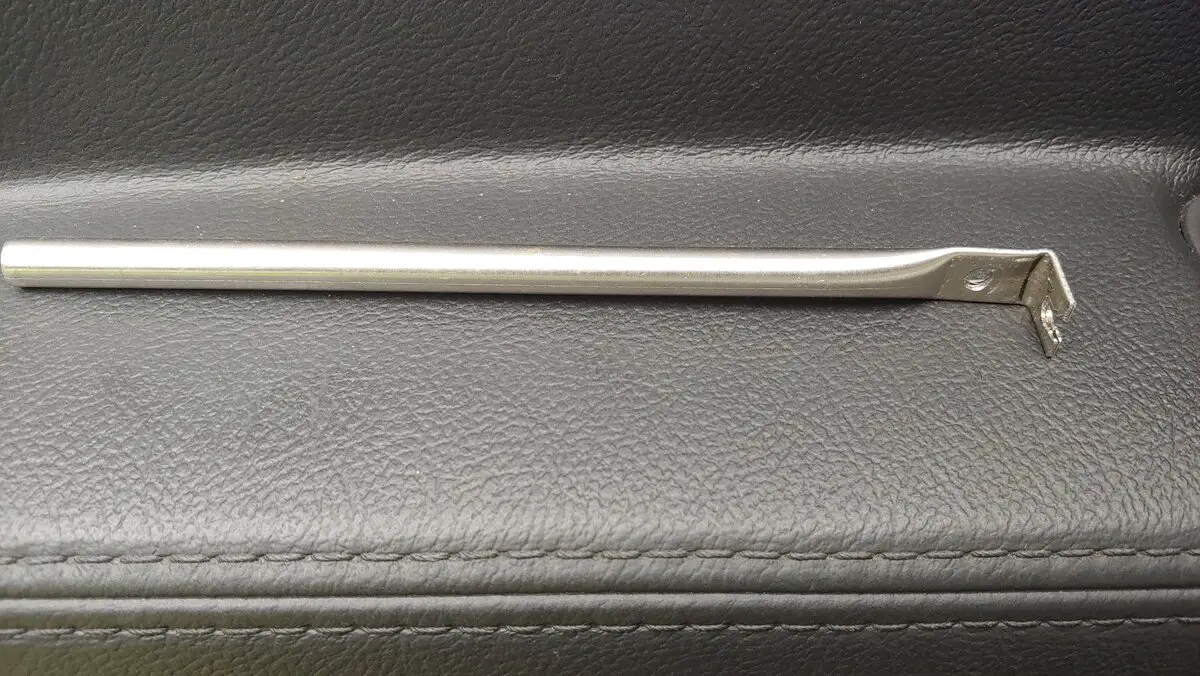

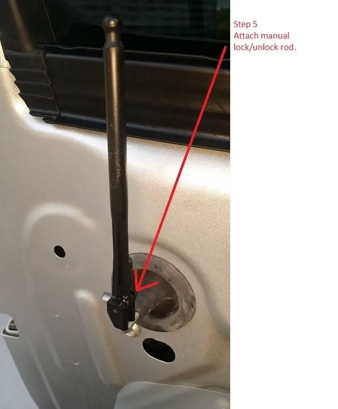

Not sure if anyone covered this already for the 2013 Police Interceptor Utility, however the following are pictures showing how to undo the Rear Door Handle Disable factory option, adding in the manual door lock/unlock rods for the rear doors, and drilling out the door panel to allow sound to come through the door panel for the rear door speakers....
STEP 1
STEP 2
STEP 2.5
STEP 3
STEP 4
STEP 5
STEP 6 (OPTIONAL)
GOOD NEWS

Does anyone have the part number for the rod?
