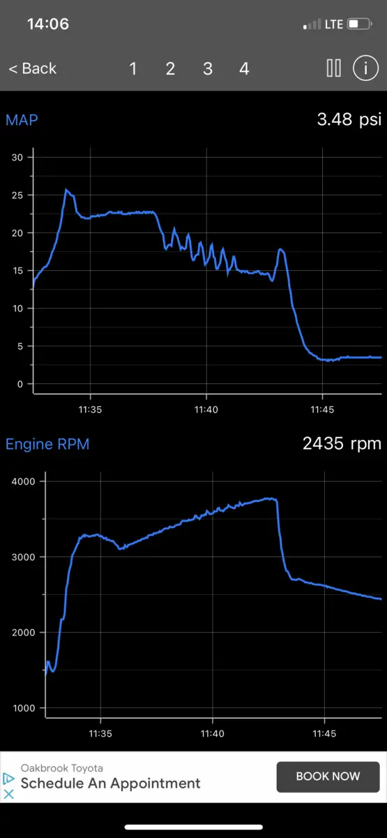

After months of trouble shooting this issue it’s finally been resolved due to your outstanding suggestion. I picked up an OBDLink reader and started logging some pulls. The boosts fluctuates at the same frequency as the RPM fluctuation. (Boost in the screenshot is labeled MAP)
I then looked into the codes (not the codes that autozone can read) and I was getting a P0234 (overboost) code. Did some research here and it was a simple vacuum line.
