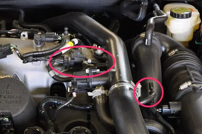

First thing I did was get a Livernois Tune and that definitely woke this thing up. I can now read the DTC codes and anytime I floor it, I get a P0299 code (Underboost). It also surges RPMs under high throttle when the DTC is present (limp mode?). Since it doesn't happen while driving normally, I suspect a turbo / wastegate issue. The "Wastegate_DC" (Duty Cycle) also reads 0 when the P0299 is present (using the Livernois Gauges). This concerns me as I understand the factory turbos are only rated to last 120K miles. I intend on replacing both turbos regardless in the next few weeks (FYI - they are hard to find!)
