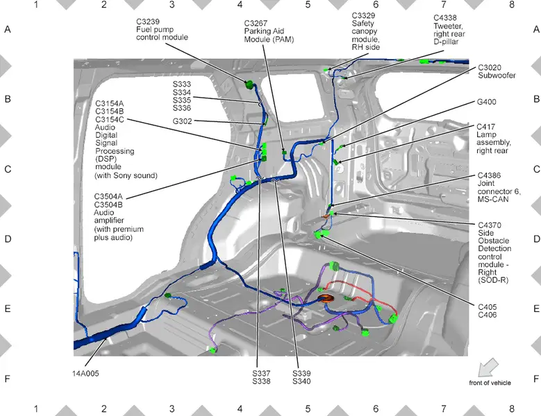

When I turn on the headlights or the parking lights, the LED circle, the side parking markers and the license plate lights do not work on both sides in the back. Totally black, so I can't drive at night. The brake lights, blinker/flashers and backup lights all work fine. I just replaced the passenger side unit because the other one was cracked and had water in it which took out the LED ring. I saw a post similar to this on a F150 Forum that said the problem was with the C405 connector getting wet. Has anyone seen this before? If so, can you tell the location of the C405 connector? Here's a link to that discussion: Tail lights and Plate lights not working - Ford F150 Forum - Community of Ford Truck Fans
