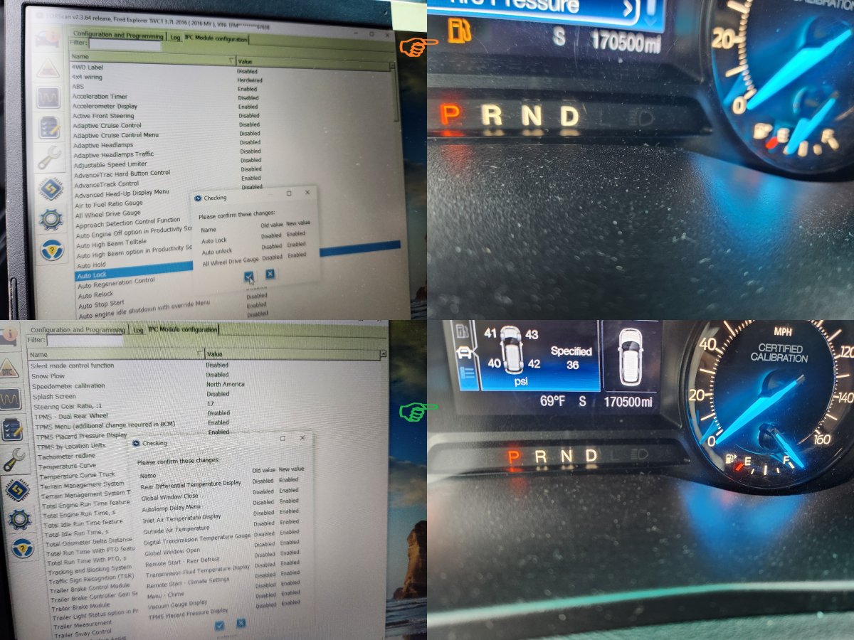

I have enabled RKE and auto-lock/unlock for a PIU before. You may want to double-check your BCM settings. Some police features such as the police rear door will need to be disabled for this to work properly.At the risk of sounding argumentative, auto lock & unlock does not work correctly, even if enabled on PIU. I'd like to have that...but it must be turned on with every re-start...
(To that end, Forscan shows an option of adding the auto windows up and down with the key fob...but this also doesn't work in the PIU)

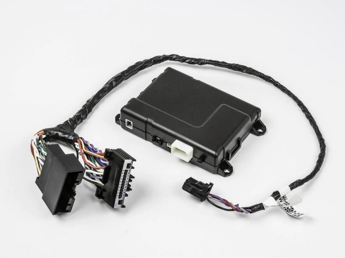

Remote start settings may be enabled in the IPC...but r/s ill not function without an aftermarket solution to turn it on.
Keyless entry is already in the truck...but the fobs must be enabled via IDS to function.
I have a '16 PIU and have gotten familiar with them. I have installed via Forscan and some hardware, auto headlights, intelligent AWD gauge, park lights flash with lock, horn honk with second lock press, disabled DRLs....and I'm sure some other things I'm forgetting...
