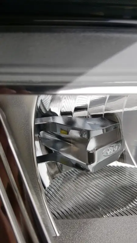

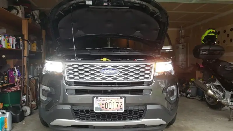

Got the bulbs installed and turned them on and got nothing. The halogen bulbs are not sensitive to polarity, but the ballasts for the LED's are. Turned the plugs around and night turned into day! The colors are almost perfectly matched. The bulbs and ballast fit nicely into the housing and the rubber cap went right back on. I'm very happy with these. I installed a set of their H4 LED bulbs in my Yamaha FJR1300A a few months ago.
The front view shows the LED on the left and halogen on the right.
Got the bulbs installed and turned them on and got nothing. The halogen bulbs are not sensitive to polarity, but the ballasts for the LED's are. Turned the plugs around and night turned into day! The colors are almost perfectly matched. The bulbs and ballast fit nicely into the housing and the rubber cap went right back on. I'm very happy with these. I installed a set of their H4 LED bulbs in my Yamaha FJR1300A a few months ago. http://s3.photobucket.com/user/chazglenn3/media/bulb.jpg.html http://s3.photobucket.com/user/chazglenn3/media/comparo.jpg.html The front view shows the LED on the left and halogen on the right.

It was just a bulb swap. They appear to add some light when in use but the main advantage is the color match to the low beam headlights. As mentioned, if they don't work, flip the plug around. Let us know what you think!
