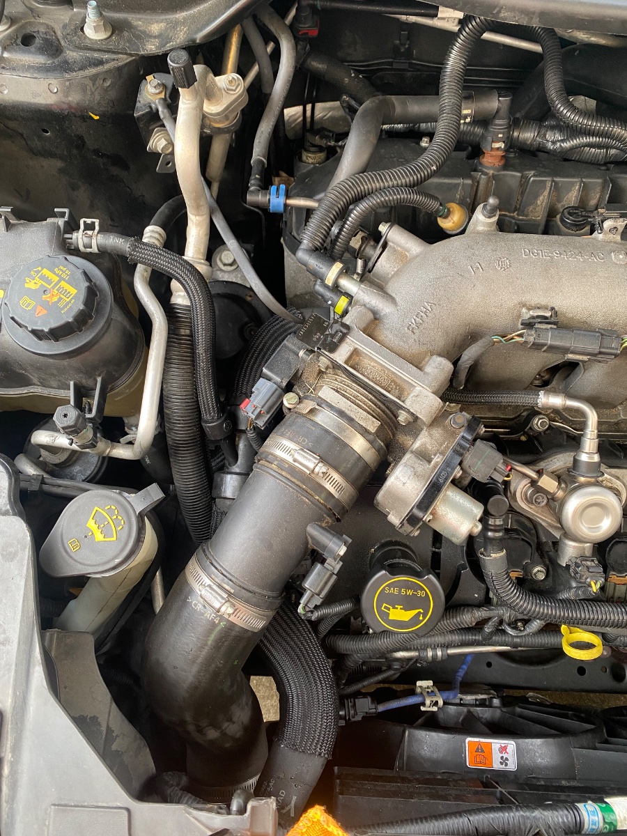

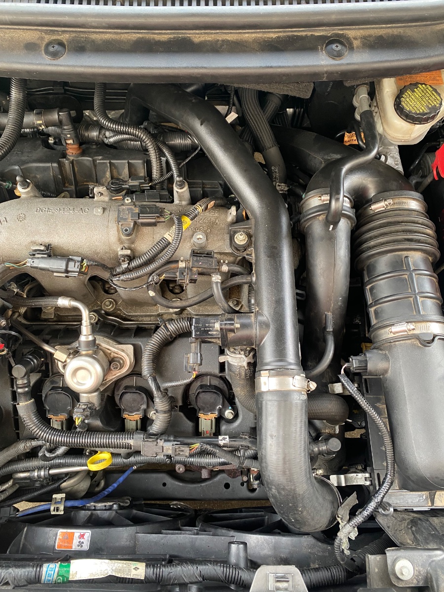

Can anyone familiar with my vehicle and engine please tell me where to look for my vacuum pump. Im looking all around and I am suspecting its is between the engine and firewall, but I can see it from any angle I try to look. Hopefully the pictures help. I have taken the heat shield and engine cover off.

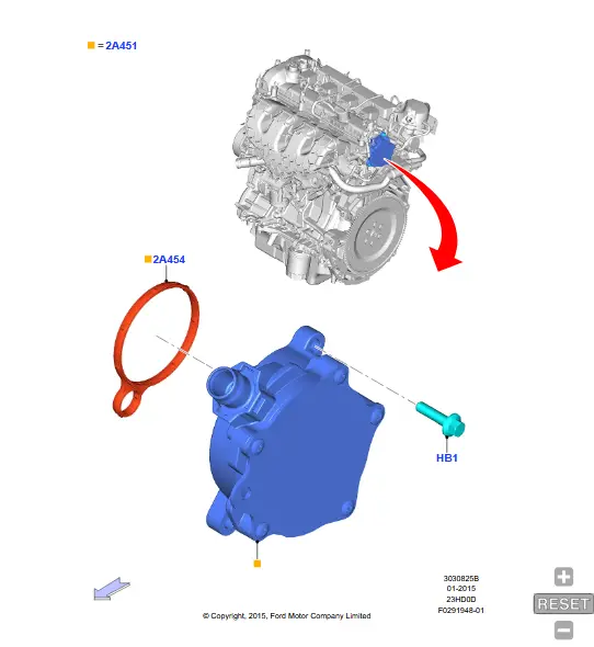

When I initially found the part, it showed the location of it on the engine but I don't see it now in the link I provided.
I don't know if this helps.
Peter
Not even a 3.5l V6 engine in that part photo....

I have look at the Engine section of the Ford Factory Service Manual. There is no mention of a "vacuum" pump on the 3.5 EcoBoost Engine. Even look at the Engine overview and Component View. See Attached
Looks like these are on the 4 cylinder Explores. Shop manual has it listed on the 2.3L 4 cylinder Ecoboost. It is listed as a Brake vacuum pump. You have a 3.5L ^ cylinder Ecoboost
