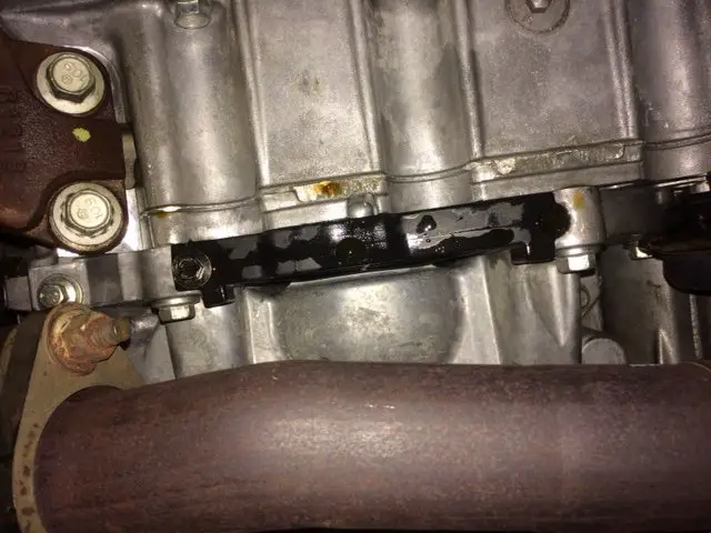

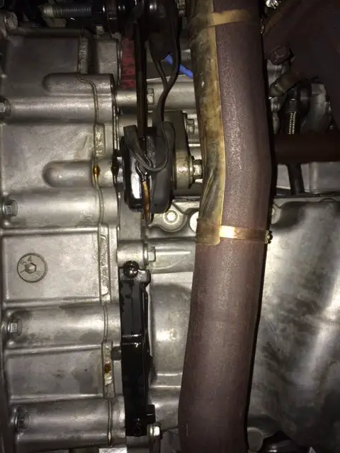

Attached are a few images, to see where the oil is on the engine.
Leaking from black rubber flywheel cover:
Underneath view, looking up:
