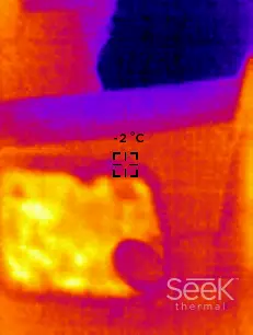

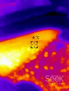

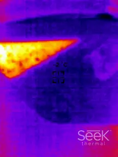

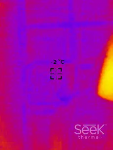

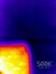

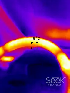

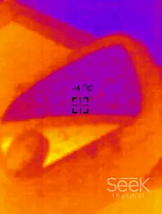

With remote start settings set to "AUTO", rear defroster comes on with remote start but not the heated mirrors. Checking with my infrared temperature gun, I could see the mirrors heat up as soon as I pressed the brake and pushed the start button to bring it out of remote start mode.
Dealer technician and Ford Hotline Support say this is impossible. The mirrors are hard wired to the rear defroster. The mirrors must come on if the rear defroster comes on. They don't!
