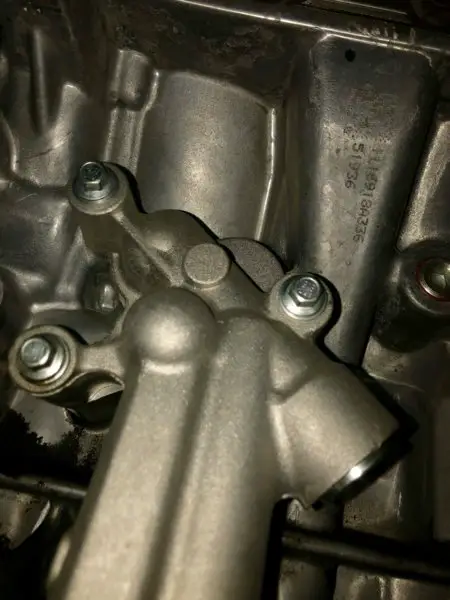

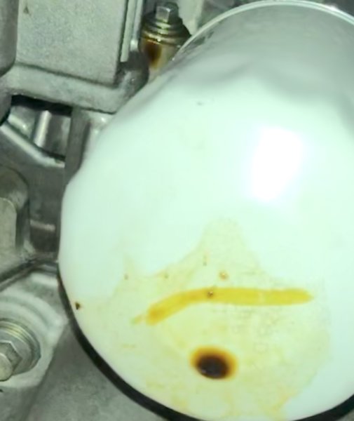

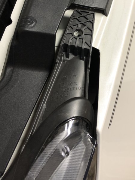

just bought my 2018 Explorer Limited with 3.5L standard in Dec.’18, It was manufacturer in July ‘18.
I’m finding a lot of missing/incorrect assembly, is anyone else finding this too? Here’s 2 examples, missing bolt for drivers side headlight assembly, and oil leaking from bolts atop the oil filter.

Manufacturing defects should be covered by the warranty. The missing bolt should be an easy replacement but I'm not sure about the cause for the oil leak. Is it possible that it is actually coming from the filter because it isn't tight and accumulating on the bolt? Is the oil level down?

Oil filter adapter gasket covered by the warranty. The gasket was half folded inside the adapter not sealing a thing. Regarding QC a joke - I just watched a dozen video posts of the guys partying or stoned and dancing on the assembly line, Ford doesn’t care? Hope nothing else goes wrong.

Finally getting around to some updates. Oil started leaking from the oil filter adapter within 2 days of changing the gasket. Dealer replaced the entire oil filter adapter, no leaks. They think it was warped.

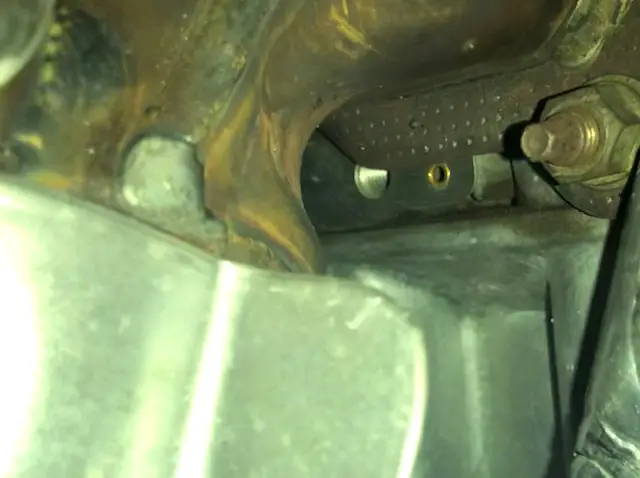

When I checked the oil filter for leaks, I saw 2 drips coming of the bottom of the engine, traced it up the back side to the front engine cover. Dealer had to replace the front cover gasket compound. Seemed to be leaking at the head and block joint. I've seen other postings with same photos. Remember, mine is a 2018 with 4000 miles on it now.

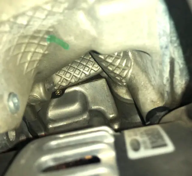

I've got 15k miles on it now and still leaks oil and exhaust smell. Dealer says exhaust smell is known issue with no fix. The persistent oil leak seems to come from between the head and block, see photos, wet behind the alternator and oil seems to burn off just under the exhaust manifold.
I've got 15k miles on it now and still leaks oil and exhaust smell. Dealer says exhaust smell is known issue with no fix. The persistent oil leak seems to come from between the head and block, see photos, wet behind the alternator and oil seems to burn off just under the exhaust manifold. View attachment 316463View attachment 316464
Dealer says its road grime (?)
Is your oil level dropping?
Nope, looks like it stays exactly the same. Oil leakage looks to be minimal, 20-30mLs maybe
