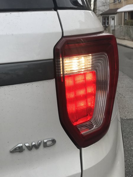

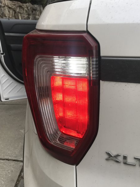

Hello everyone, I purchased Sylvania LED bulbs for the reverse lights and turn signals for both the front and back. They work just fine at regular speed externally but I am getting the hyper flash on the inside which is really annoying. I then went out and got the Sylvania resistors but they are hard to install for two reasons: 1) there is very little room in the front between the 3 wires that connect to the turn signal bulb and 2) I don't know which wire they go through.
Has anyone ever done this to avoid hyper flash on the newer explorers?

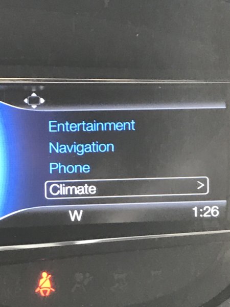

I was able to get in and disable hyper flash and also enable climate control from the steeringwheel. My 2013 had that option. Why did ford do away with it from 2014 til now? One of my favorite options
