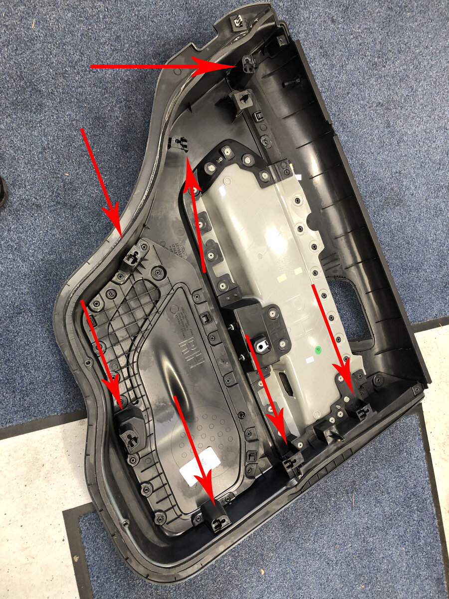

Here's a PIU panel with arrows showing where clips could be. They hold on crazy tight.

I'd bet the panels mount the same whether it's a PIU or civilian. I put civilian panels in my Interceptor. They may or may not use a clip in a given place...but they mounted in my '16. The door handle bezel (if memory serves) can stay not he panel, but the cable can get in the way. The handle/bezel can be popped out and rotated to get the panel off.
Here's a PIU panel with arrows showing where clips could be. They hold on crazy tight.View attachment 430296
Awesome, seems I should've been able to pry the panel out... But, I tried it again just now, even the edge came out more than an inch, all around, the panel just won't pop... See the yt video recorded.
