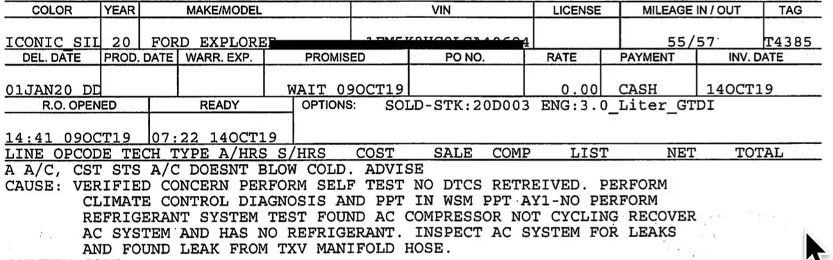

I'm considering buying a 2020 explorer limited. I was going to drive over and test drive it (about 2.5 hour drive each way) and dealer emailed me saying there was an AC issue, wasn't blowing cold air like it should. They checked it out and one of the AC lines had a leak and was defective. They said it was replaced and it is good to go.
Any one see any issues with this? I find it odd a new car could have an issue like that. It is actually a courtesy vehicle with 2k miles on it.
