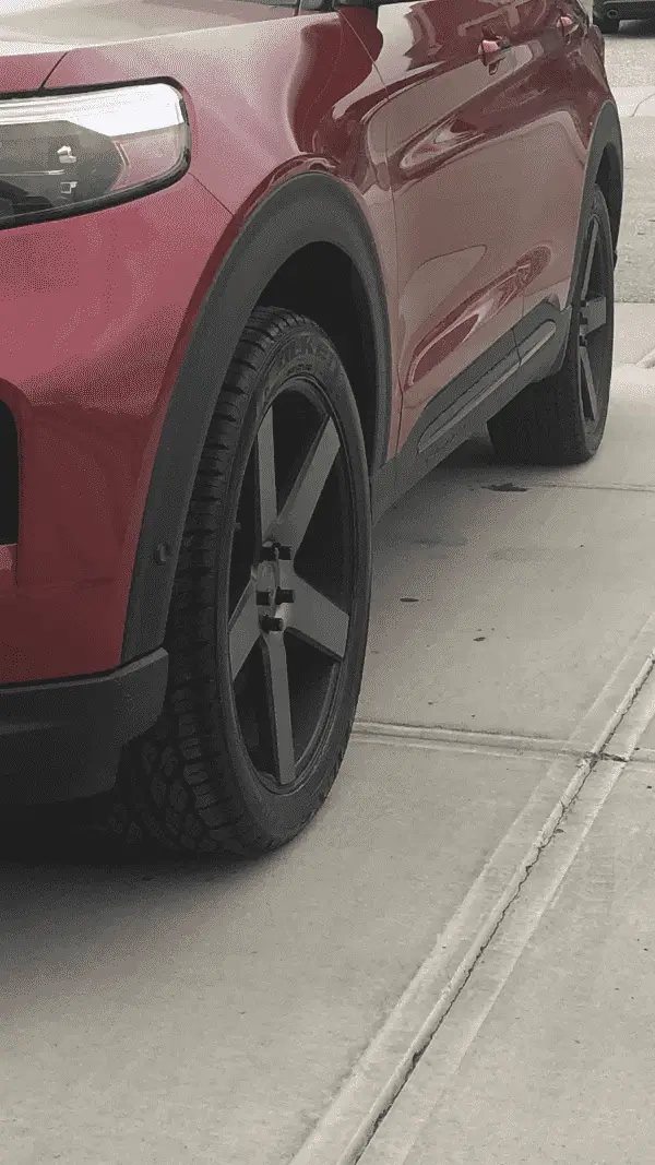

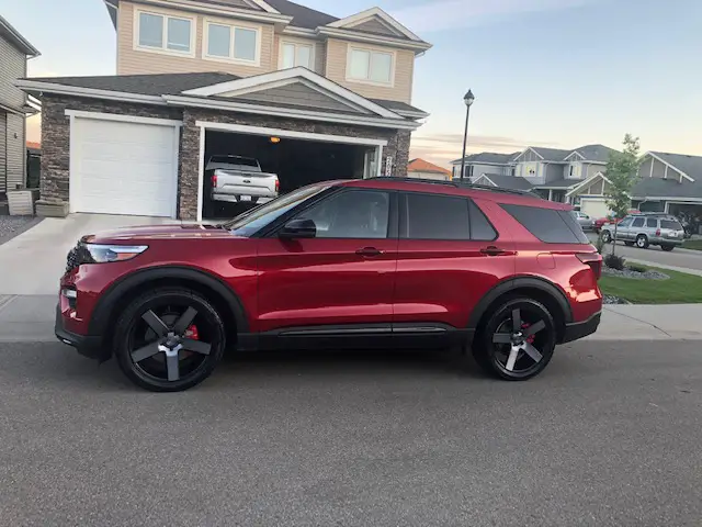

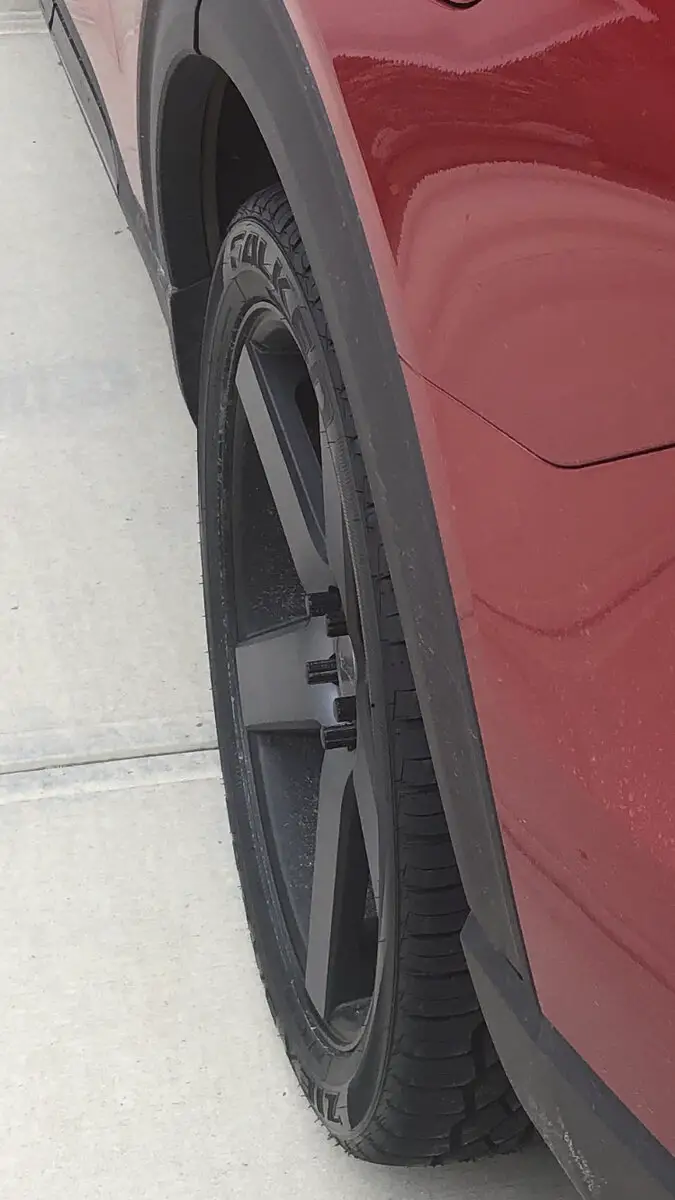

If you want perfect fit you have to make a compromise somewhere. Either 2 different offsets or a 1/4” spacer out back. The rear wheels are right at 1/4” further in than the front...as the OP’s pics show. An 11” wheel is asking a lot and I think your +35 offset is gonna create more clearance issues up front. I’ll run the numbers after I make this post. BC Forged is making my wheels now...and I like the same stance as the OP...dead flush. Since I don’t want any issues as I’ll be dropping mine I went with a 22x10.5 +30 and will run a 305/35. A 315/35 will also fit well...I may swap later if I need to push the tire out a bit. I decided to run the same offset on all 4 corners to make it easier to rotate the tires but I have some 1/4” billet spacers to correct the rear.
