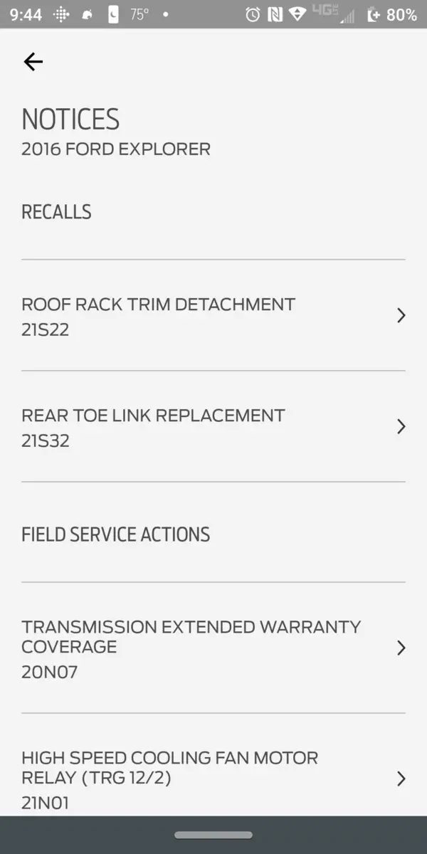

So I see that there is the 21N01 Cooling Fan Relay "Field Service Action". Anyone know anything about this one? I found out because it showed up on my FordPass app.

Here is a snap from the FordPass app.
