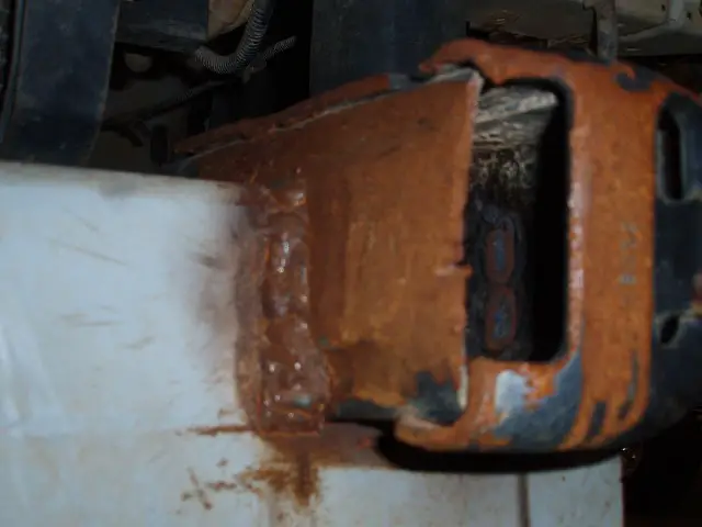

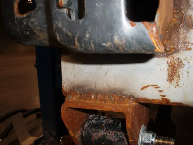

ya james we will see how rewarding it is for you when your truck falls apart on the highway and blows up. Yeah i would of liked to have done it all myself, and you cant say i didnt try, but it just became unreasonable for me. Yes im sure plenty of people out there, just like the ones on this site can learn and build it themselves. I also dont think one of those people is you. I mean come on james, the guy i paid to come do welds, were 100's times better than yours, and when bryan put my car up on the lift two of the welds just snapped off that he had done. Im not trying to be an #######, its just i dont think your truck is going to be safe.

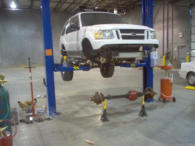

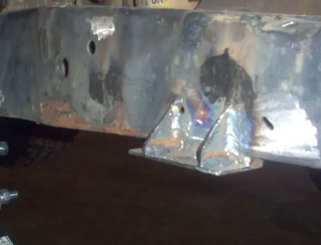

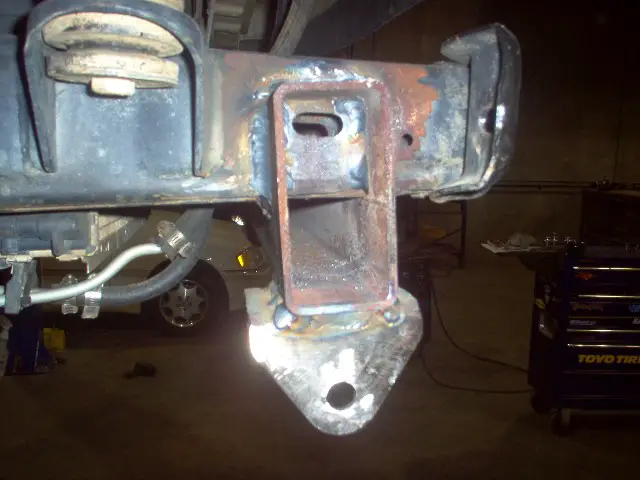

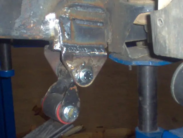

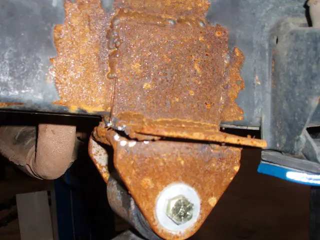

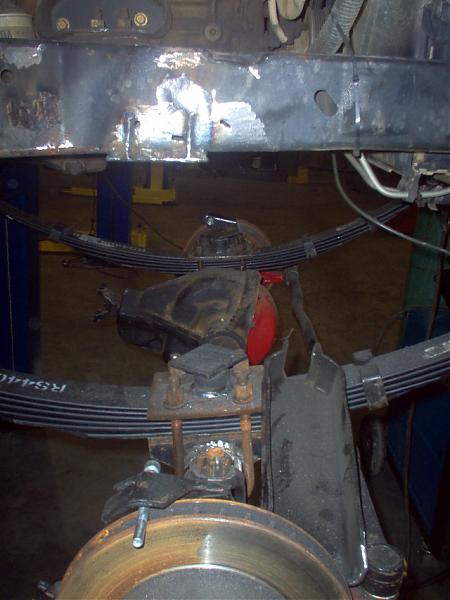

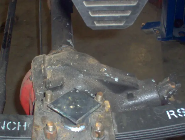

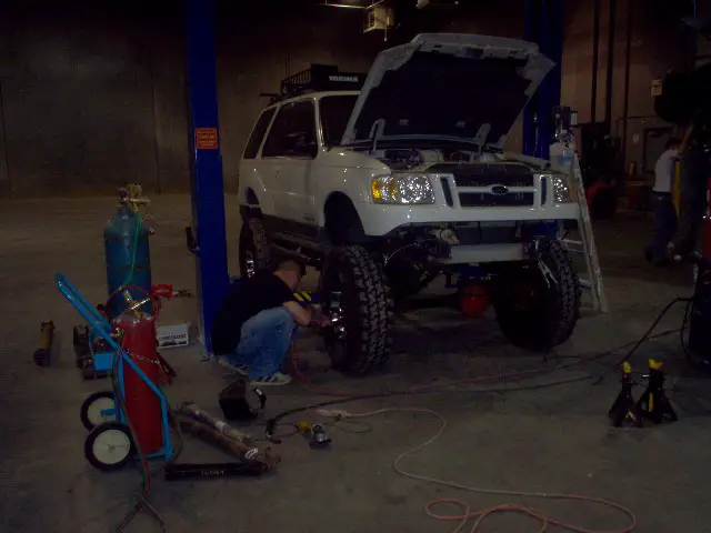

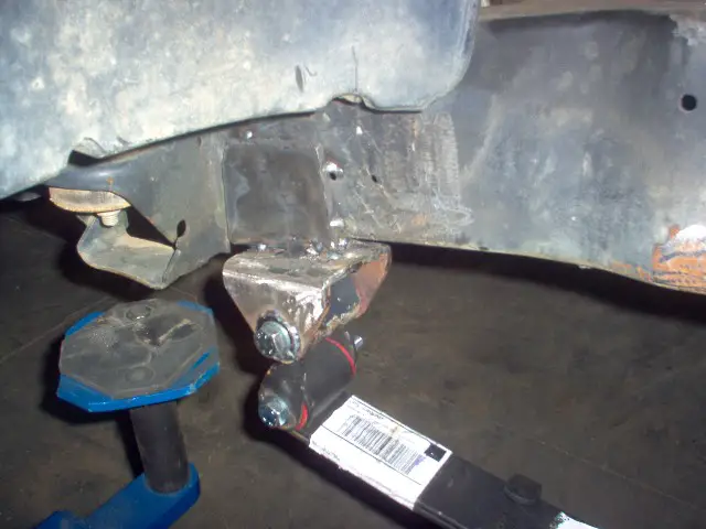

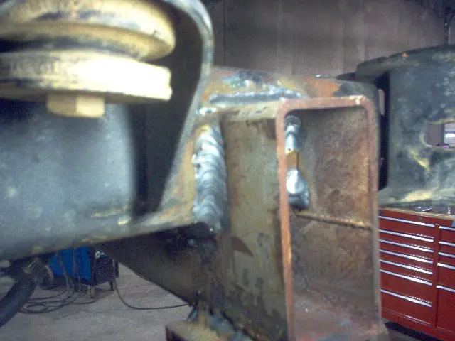

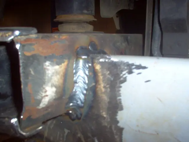

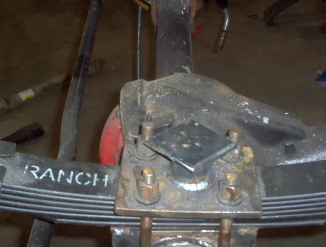

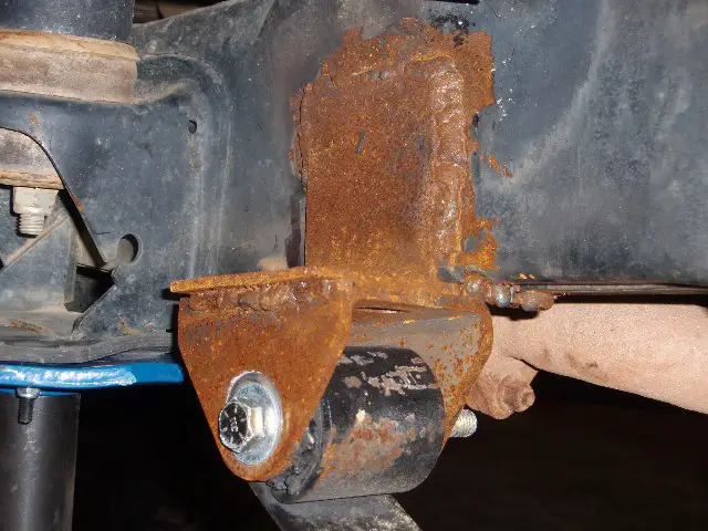

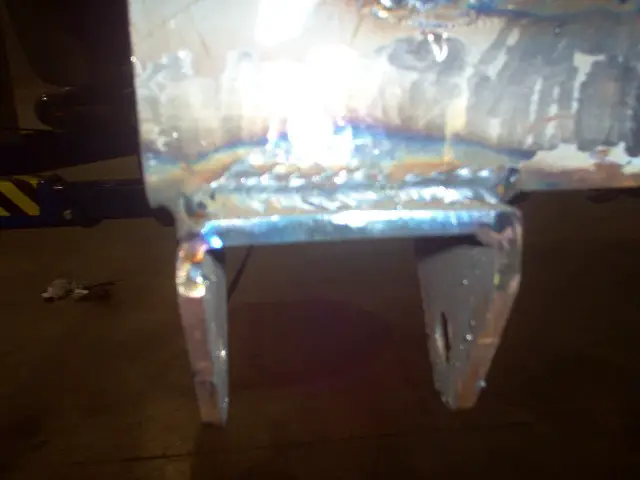

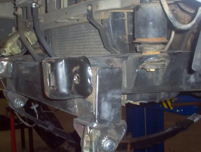

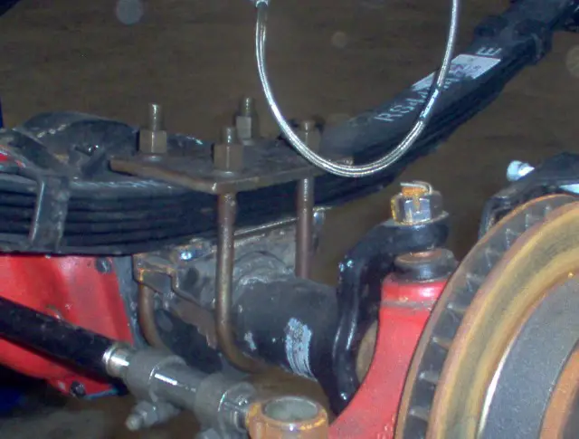

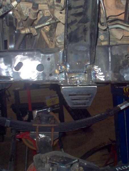

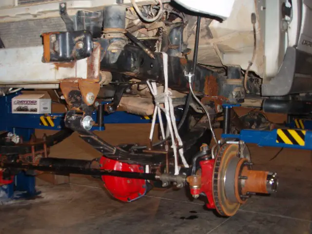

Okay, here's a bunch of the pics we've taken so far. These are all about 1.5 weeks old. Since then, we've installed trans & t-case, installed a set of stock Explorer springs (others were shot, one side sagged 2.5" lower than other side), 3" lift blocks in the rear, buffed/painted frame & diff covers, cut off frame horns and capped off frame, built a custom skidplate from behind grille to bottom of crossmember, cut off rear perches, put on rear shock mounts/shocks, new steering lines, tranny flush, oil change, new fuel filter, coolant flush, cleaned throttle body, built rear bumper brackets, etc etc etc. Hopefully I'll have pics of that stuff soon.
We're trying to have it finished for Robbie by the end of this weekend since he'll be home, but if it's not completed by then (still waiting on gears and some other things to come in), we'll be delivering it to him at school next week.

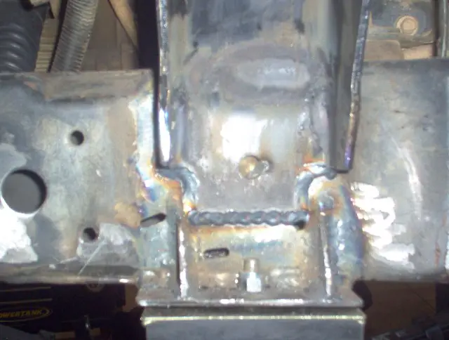

Looks much better, keep the pics coming as you get them. The truck will be much safer now with the better welds and some re-inforcement. Looking forward to seeing more progress!!!
Is he going to leave the body lift on or take it off?
He's leaving the body lift on.

New fab work looks real clean. Those old welds were hella nasty. Bump stop mount on the axle is a little goofy but it'll work. Looks good.
Nice. What kind of welder was used?
All the pics are at work still. We got the double cardan shaft rear driveshaft today and will be re-rewelding the rear perches tomorrow since we had it setup for SOA w/ AAL and regular driveshaft. With the SOA w/ blocks and stock leaves it droops a whole lot more, and bound up a LOT at full droop.
We cut out our old steering box setup and rebuilt brackets to make his drag link work that he had to use...so crossover is no longer needed. Gears and true-trac are both in now (would've been in last week but parts came in late). We have a lot of little things to finish up tomorrow, but it's getting extremely close to being drivable. Pics to come soon.
