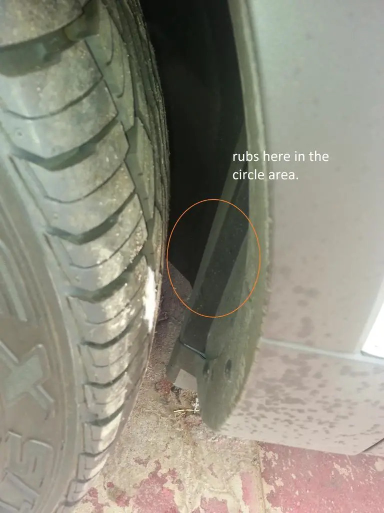

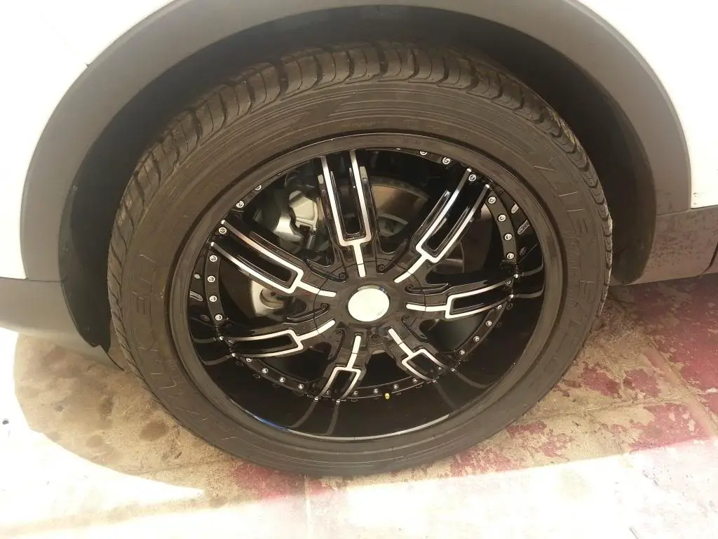

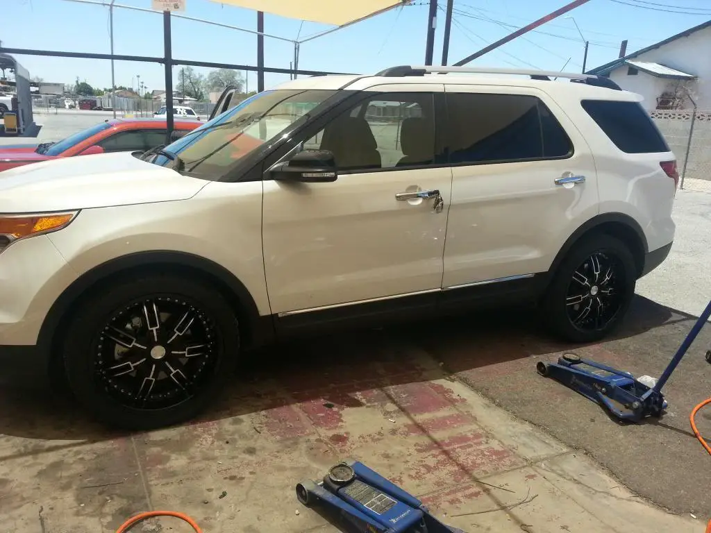

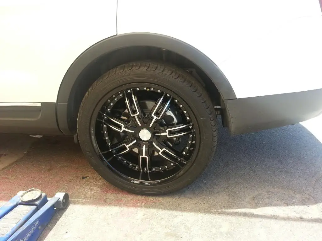

Here’s some info for you.
I tire guide reference shows the maximum size allowed is 265/40R22. This size fits, but leaves a gap, and looks terrible. If you plan to modify the suspension then you could fit the 285/45R22 you want to do. I tried the 285/40R22 it the tire is almost perfect, it rubs slightly when turning, but it’s very minimal, something I can deal with. This tire is the winner, without modifying suspension, and it looks much better than 265/40R22.
Don't worry I'm not keeping these wheels.
BTW, 285 in the front, and the 265 are in the back in the picture with the whole vehicle in the shot, in the picture with just rear of vehicle it is a 285 in back.
Let me know what you guys think of these wheels, I'm very borderline about them, their not ugly, but their not perfect either.
