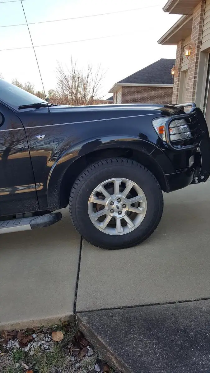

Will they fit a 2007 sport trac limited 4x4 on stock wheels without lift?
Yes, 265-65-18 will fit, as will 265-75-18 if you want a little taller appearance. I've read here & elsewhere that some folks will see rubbing up front at full-turn-lock... others don't. Wouldn't sweat it if you aren't making full sharp turns regularly.

It seems Cooper also makes the AT3 in 255/70R18 (~32in, but less wide, so hopefully less chance of rubbing).
I had 255/60R18 Grabber AT2s, and they rubbed a bit on full lock when I first got them.

I just picked up some Bridgestone Dueller A/T's in 265/65/18 and I can say they do rub ever so slightly at full wheel lock. No big deal though. I definitely like how they fill out the wheel well a little better than the stock 235's.
