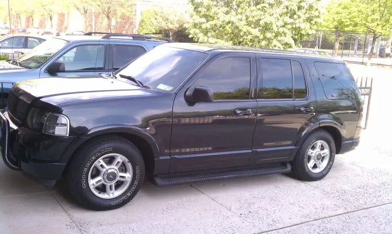

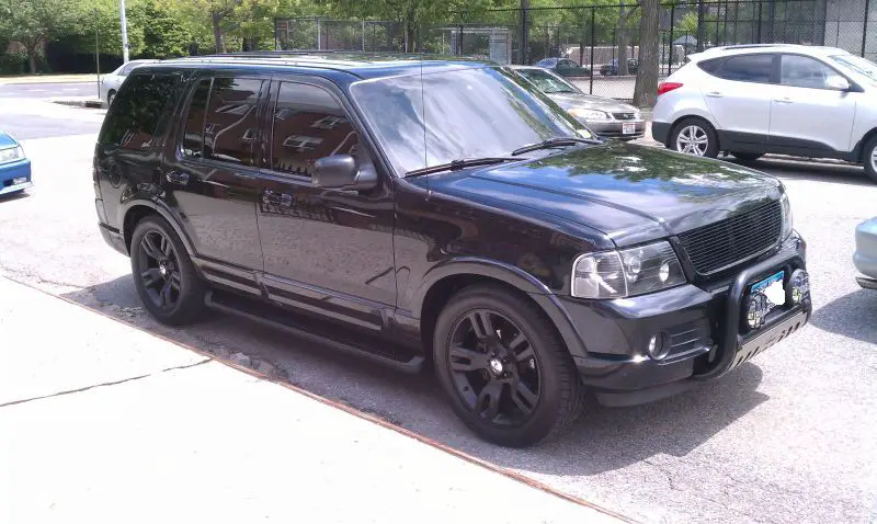

im pretty sure they would...i have stock adrenalin wheels with the 255/55/20 tire on them...the 275 should fit...many people on here have them...

thanks for the lesson that i knew already...i know the last two numbers are the wheel size...and my stock ex came with 16" wheels....i ran 17" wheels from an svt cobra with 275/55/17 tires on them...and now i got my adrenalin wheels with the 255/55/20 tires...limited02 i believe is running a 275 tire with 20" wheels on his explorer...dont know exactly what you meant from that reply but as armysoldier said its all about the back spacing on the wheel...but these trucks can run a 275 tire on a 20 in wheel...
and mine is lowered...:thumbsup:
