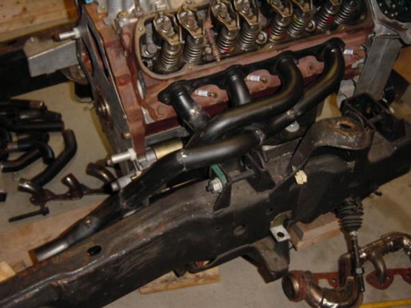

You can see how my FMS headers mostly go upward from the ports to avoid the framerail. I'm looking though my pictures for better pics.

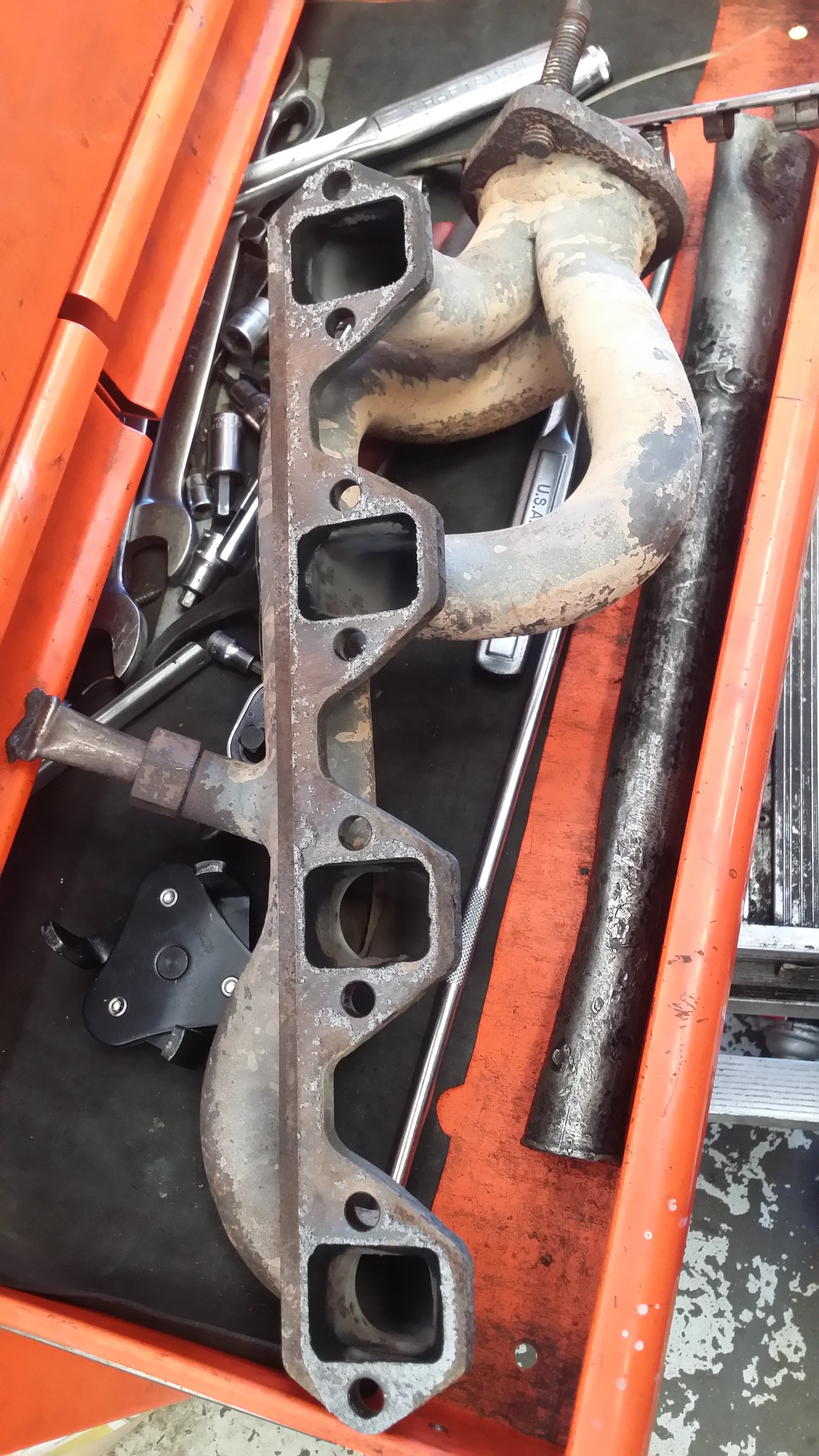

Here's the older manifolds, the starting point, for 96/97.5 GT40 heads.

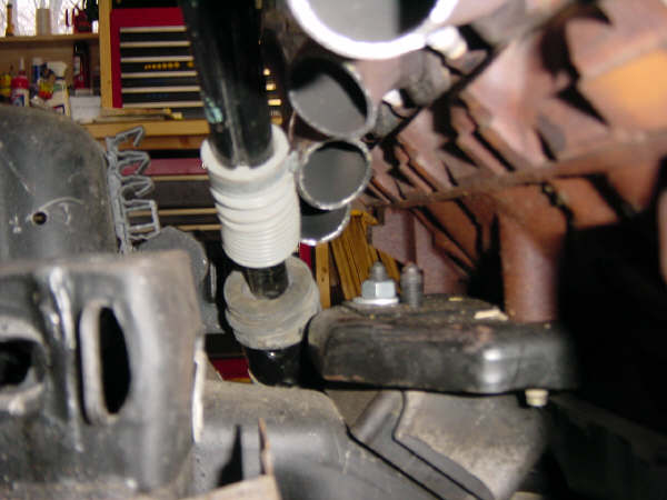

Here's some pictures I've collected over the years. Most of these are Todd's from his Ranger project, and his frame section/jig. Notice the right side isn't a big problem, it can be done well, with 1.625" or 1.75" pipes. The driver's side though has no room at the steering shaft, and also as Jon alluded to, the collector/pipes are squeezed down between the block/trans, and the fuel/brake lines. That is the smallest choke point, before it reaches the pinion yoke and driveshaft. Creativity is required, and the current choices have little to none.

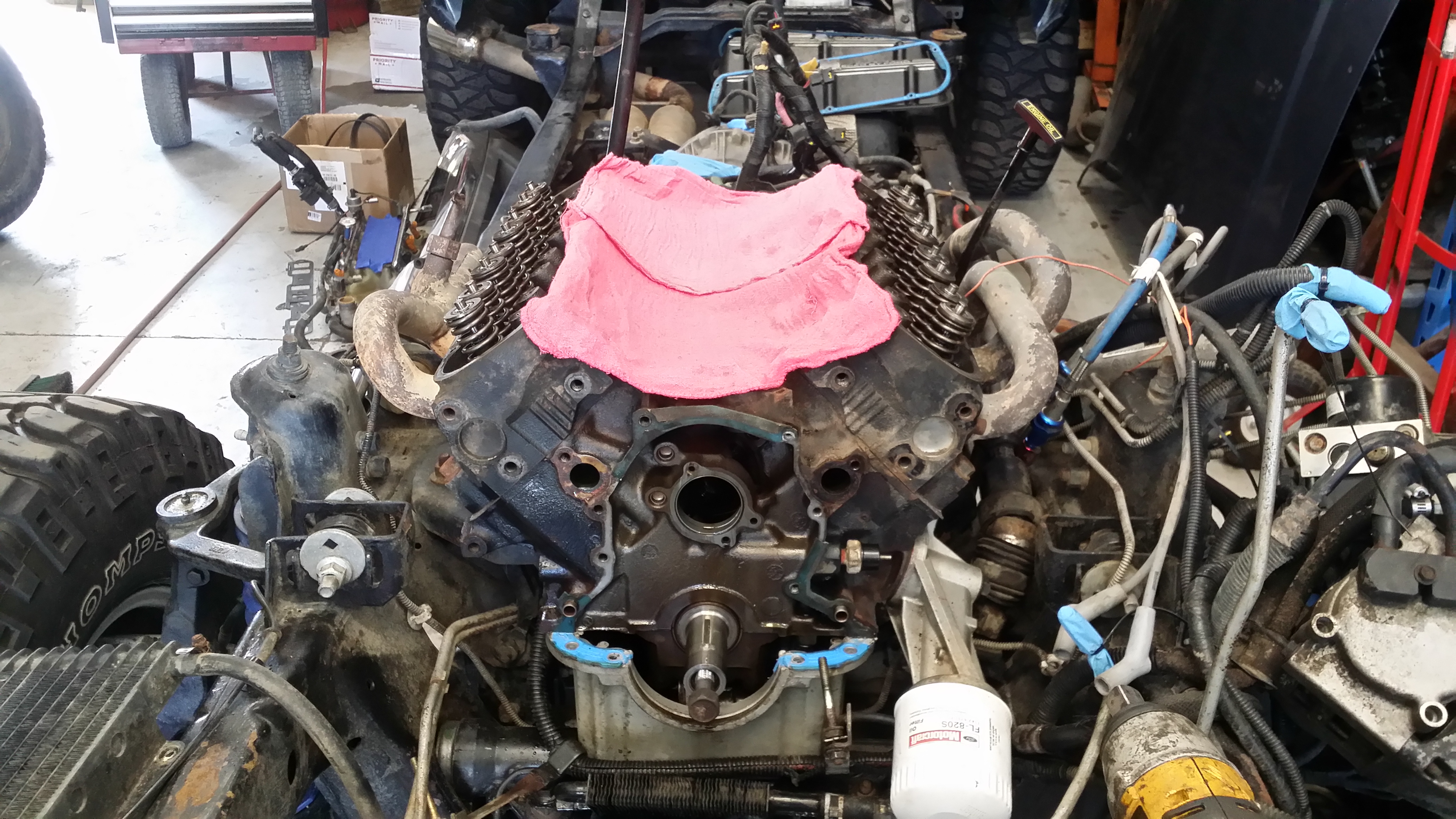

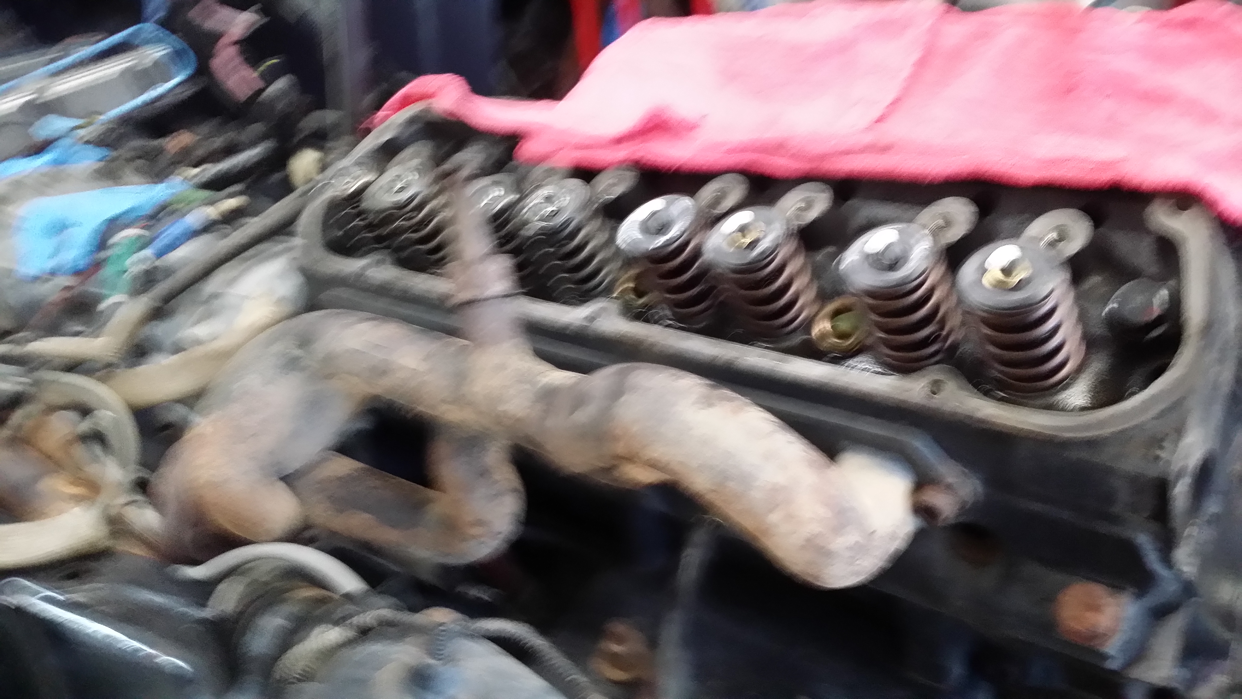

just so everyone knows i have the non p early manifolds on my p heads , my motor is a or was a 99 , they fit fine with no problems with the plugs ,
Not saying the early ones are better than the cast iron ones , they are much smaller but i believe they are a good choice to copy only bigger
